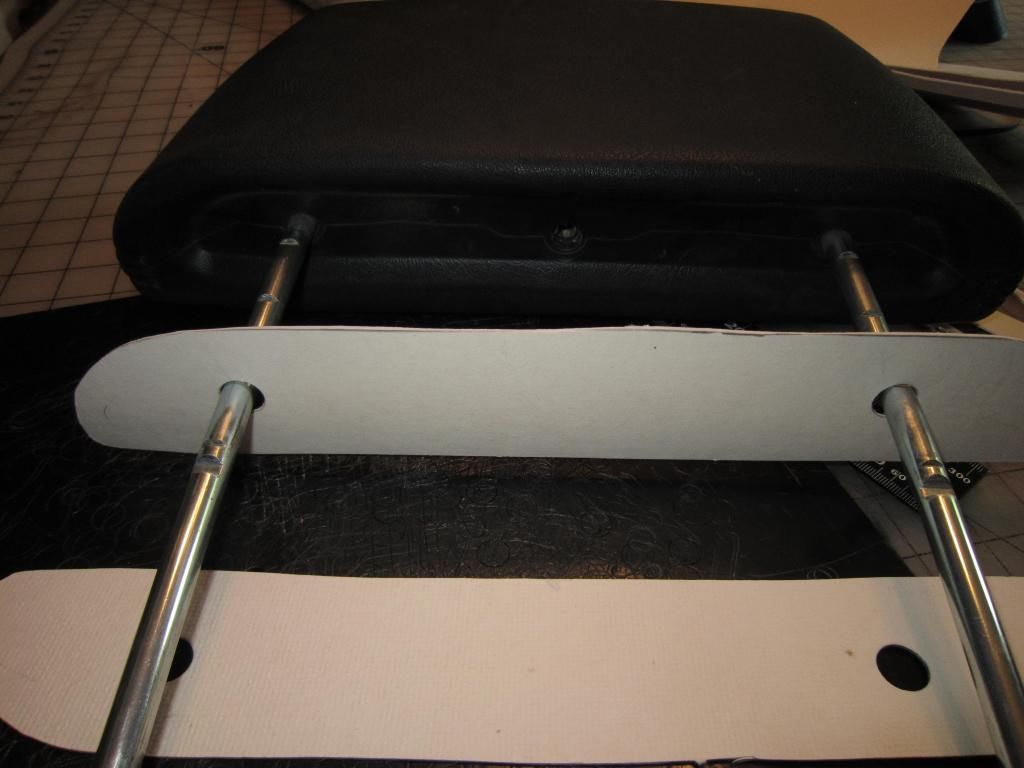

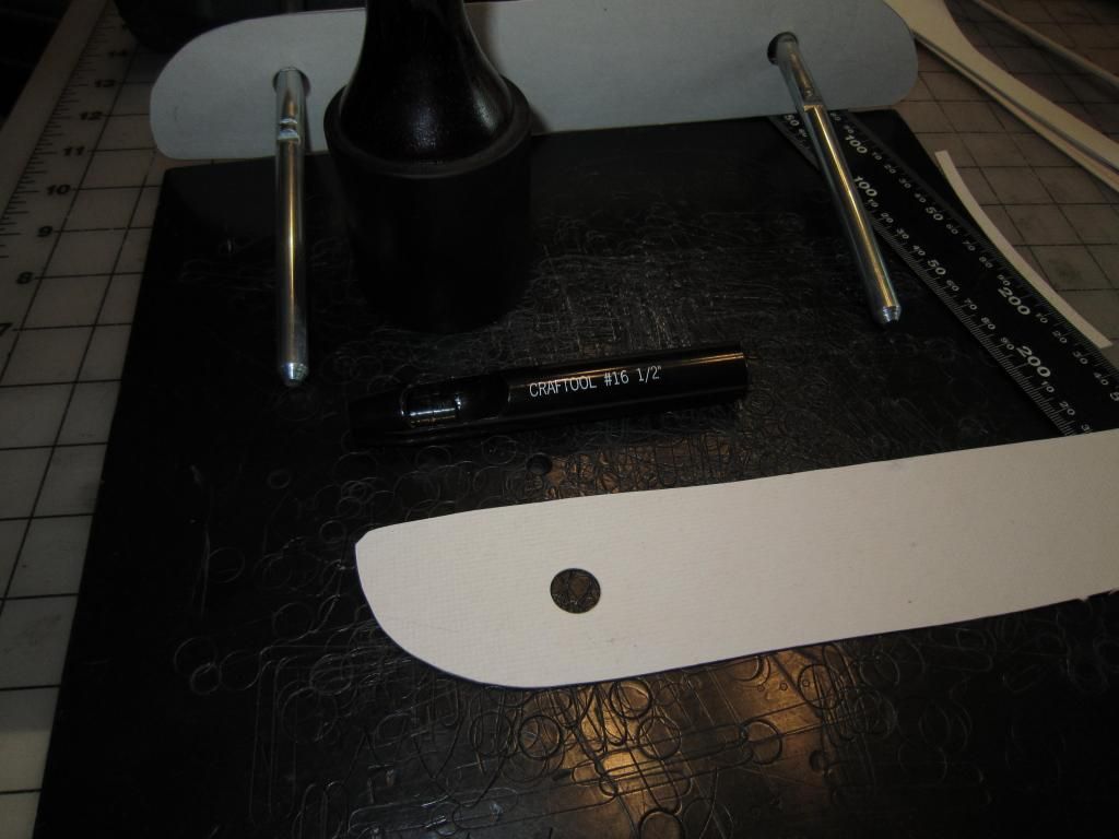

That was the first set of head rests I've done.  I watched a couple of YouTube videos to get some ideas on fastening it on the bottom side.  I wound up cutting some stiffening card board to put on the bottom to staple to.  That worked really good.

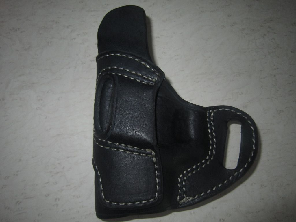

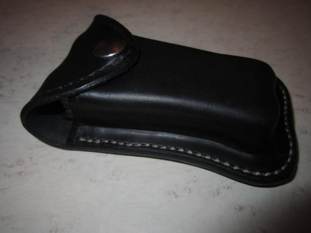

First gun holster.  This is for my 40 Springfield XD Subcompact.  The first 2 are wet forming.

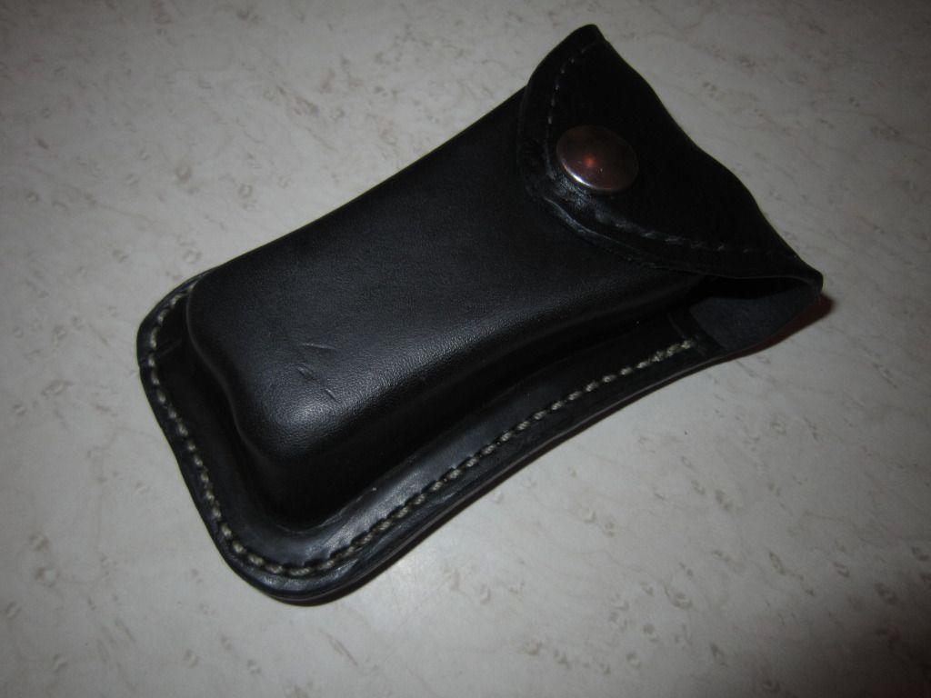

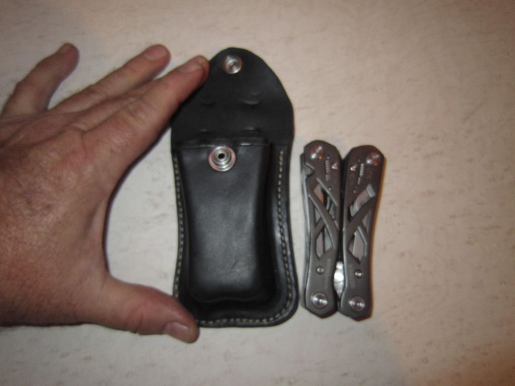

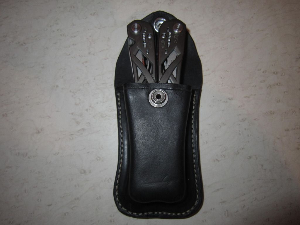

This is for a Gerber Multi Tool.

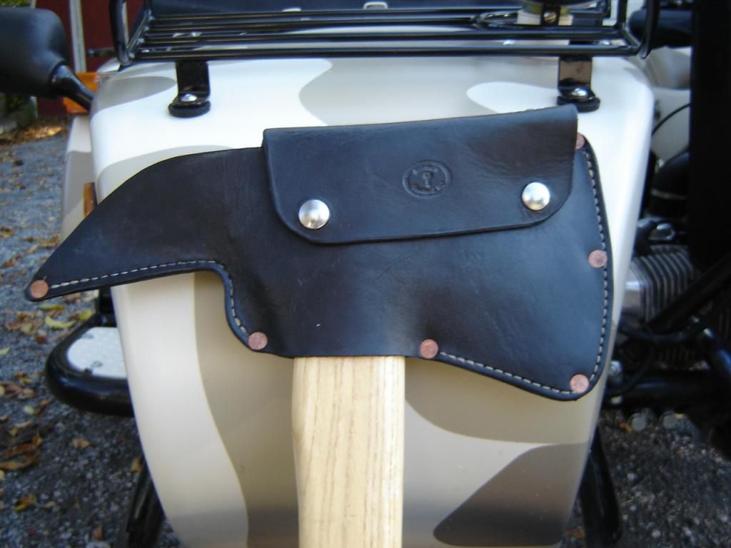

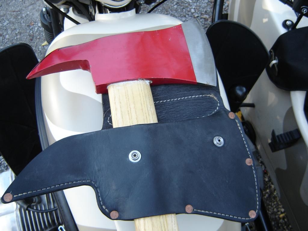

Ax head cover.

Great job Bobby. The holsters came out real nice. I like them. :)
