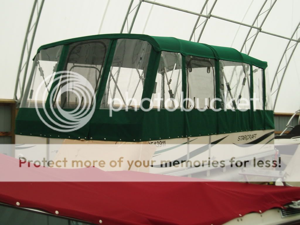

Boy don't that look familiar Mike. Did one very similar week before last.
http://s918.photobucket.com/albums/ad24/71V153/
Doug

Thanks Mike. Yeah it sure is nice to have the boat in front of the shop. Sadly that doesn't happen very often.  But if that is the case I try to have a blank sewn up before the boat gets there. Why waste time patterning. If everything works as planned I can usually knock em out in a day.
Now that I know a lil more about how your half patterning system works I might have to give it a try. On a smaller scale for starters ... cuz I can see myself screwin' that one up big time!  Heh heh heh

Peppy CC's boat was about Identical to mine    He patterned with a blank so naturaly
kept the cover high as the window.  What I did was make my pattern half on the window side but i supperted my poles with a strappng tape down the centerline  with side to side tapes to center them from falling over. I had to crawl under tape. I patterned the side around the window with a seperate pattern pocket oven the window  then I copied that side as is and for te port I just eliminated the window bump up and cut the fabric flat.  No pocket.  It worked out great.

Quote from: Peppy on December 14, 2011, 04:40:59 amNice cover CC! I like the assymetrical stylings! The half a pattern method wouldn't work on that one!
Nah, I reckon not Peppy. Ha! Hey on poontoon boats I just let the center seam lay where it falls. Customers don't seem to mind? Heh heh
But seriously the advantage at least in this case I was able to get the 120" blank to cover the boat without needing to add material stb of the windshield?

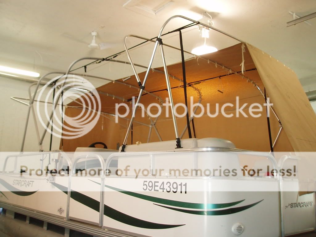

I just got thinking... What do you mean Peppy style? THIS is Peppy style-
peppy sty;e is only patternong 1/2 the boat.  i half patterned a stracraft centercondsole seck boat with a t tp[ this afternoon.
[a[[ey cuttoing it would be folfoing it in half first . i cant on this  one case the port side and walkthu cut outs atat are not on the right
Quote from: Mike on January 12, 2012, 03:31:59 pm
i was just joshing Mike. And I guess I forgot to add this picture
