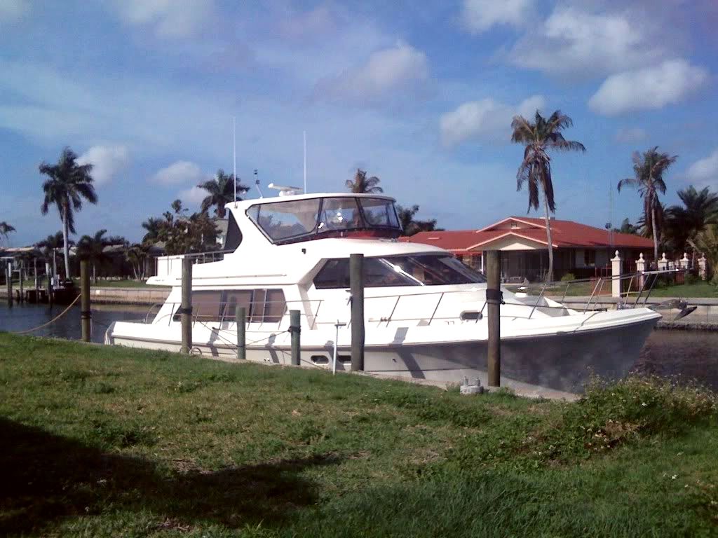

Ya I'll do a flap covering g the joint on an express to keep it watertight   Sometime on the sides if it's asked for.   On an expensive boat / job I'll make a Stip like yours rich to hide the zips from the inside  yours don't really overlap do they ? Like on the outside of my front window Ill make a flap  like 2". Over the zipper joint
It's can be confusing that way June
not too many wantto pay extra for hidden on the inside zippers
Mostly high end
last one was this big boat
