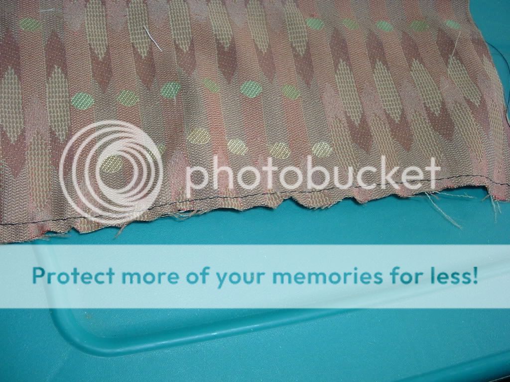

Hello,
My Juki LU-562 has decided to gather the fabric when I sew. If my shop were beside a river I would be singing 'Shall We Gather at the River'.
This would be great for a gathered skirt, but I would really like to just sew straight stitches on flat fabric.
When I turn the wheel by hand slowly, I can see the needle goes down with the walking foot. They both go back, away from me, then they both come up and travel toward me.
When the needle comes up and travels toward me, I can see that the thread is pulling the fabric back toward the needle, creating the ruffle.
What did I do to cause this and what can I do to fix it?

Sounds like the feed timing is off.   The eccentric cam on the back is most likely the culprit.  I'm postning from my cell phone and can better help from a desktop where I can post pics.
I'd like to hear about that cam also Greg. When I've had this happen it seemed it was thread tention
how could a cam do it? And gene do you meen a Lu 152 I  have a juki Lu 153

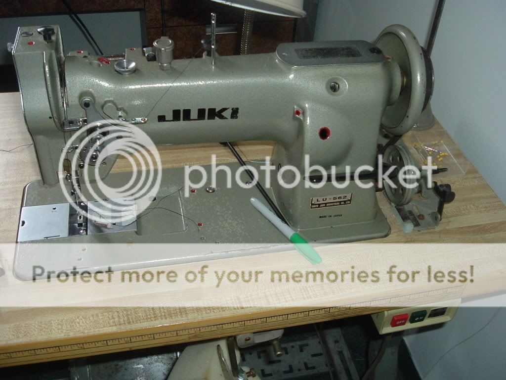

Here's a pic of my juki LU 562. Notice all the paint still on it? And ignore the magic marker. Some of us have not yet had an expensive mistake to teach us to use only chalk or erasable markers on fabric.

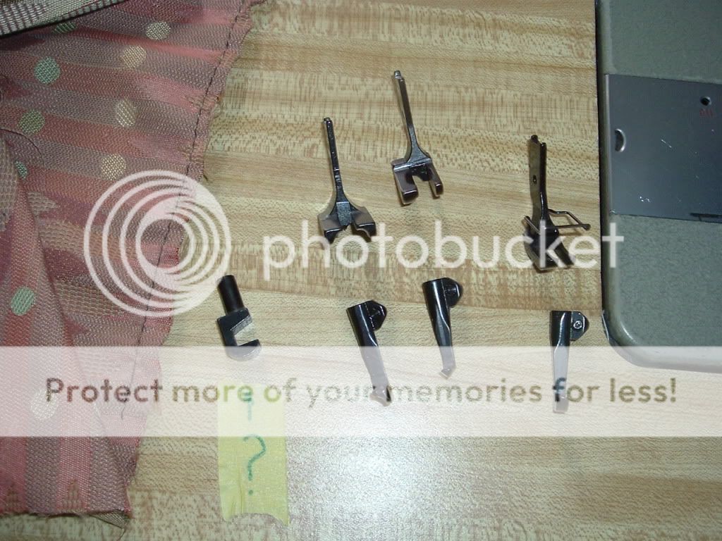

Here's a pic of my feet: regular, single welt, and double welt. I saw a video where a guy was using a Consew walking foot sewing machine. He used one set of walking feet to make his welt cord, sew on a zipper, and sew the boxed cushion. He said he used only that one set of feet for 30 years.  I assume it was similar to a zipper foot like I have on my straight stitch machine. What walking foot do I use to be able to do all these things?
And what is that thing above my question mark used for?
Here's a pic of the gathering that I would like to find out how to stop.

The part above the ? mark is a hinge that goes between the head and the table cut-out. There should be 2 of them.
It looks like in your picture that the middle set of welt feet is a 1/4" size. You can perform all 3 tasks with that set (provided that you are using 5/32" welt cord).
A true zipper foot will only get you a little closer, but it's nice to have one.
The 1/2" set will work for braided rope. The plain hemming feet on the right, I have them, but seldom use them.

If you really want a zipper foot, but don't want to buy one, you can grind the right toe off the hemming foot.
Cheryl
Until a few years ago..  the only  set of  feet I had was the 1/4"..  works fine for everything.
That pic  is sooo sweet.  Looks just like mine!  (Minus the "I love you Mom" scratched in the paint..oh - and mines a bit more worn.
Gene, Have you tried the rethreading thing, cleaning thing and loosening the tension??    Did you change feet recently??
Mine acted like that awhile back,   So bad that I quit using it and moved over to my Singer.  Then one day I  set out to fix the Juki and discovered that the head of the screw that came with the new set of feet was a hair too  thick and was interfering with the  needle bar (or whatever bar that is..)   Changing  to the old screw  fixed it. *shrug*

Hey Gene, pat yourself on the back, dude!  Your 562 has a better assortment of feet than I have available "at work"!  And that's speaking for 3 (count 'em!) walking foot machines.  If more than one of us is working on cushions and needs a welting foot.. well, we have to find "other work"!  :)
I don't know about the feed eccentric, but I do know that fiddling with the tensions can improve things.  But there is a point where tension adjustments are maxxed out and it's time to look for another option/machine.

OK, I looked EVEN closer at the welt feet pic. I see now that Gene didn't necessarily have them laying in pairs.
Looks like the one on the top left pairs up with the lower center to form a pair of double welt feet. The upper & lower right feet look like plain hemming feet.
The lower left & upper middle look like 1/4" welt feet, although I can't see much of a cord groove on the bottom.
