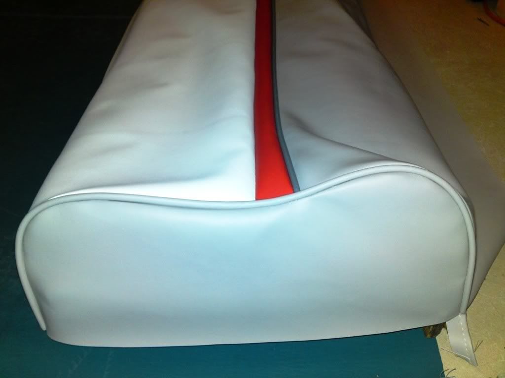

Hi Guys,
I'm working on some pontoon seats, and sewing them up as original, with a piece of stretcher canvas sewn into the seam where the welt is. Here is a pic of the loose cover:

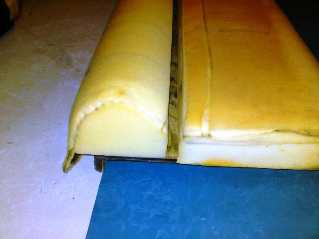

The foam is in two pieces:
When I stapled the stretcher down, it looked like the welt was buried too far down, and you couldn't really get the full effect of the stripes. (Sorry I didn't get a pic of the stapled cover; I was so dissatisfied with the results I pulled the staples out immediately.
My question is:
Do I really need the stretcher? And if I don't, should I glue the two pieces of foam together?   :-\Thanks in advance!
Yes you need a stretcher. No don't glue it. Thats me anyway. Draw a line on the stretcher parallel with the welt the depth you want to staple it. Staple it there. I usually mark it about 1/4" less than the thickness of the foam. (the thinner foam) I make my stretchers out of something with very little ply or give. Sunbrella works. If it's to stretchy I find it hard to make that welt lay smooth and you get speed wobbles in it.
