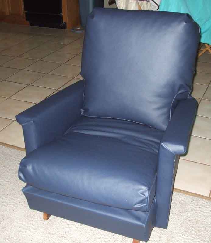

Well, the LOML and I finally finished that (insert your favorite wordy-durd here) chair. All went well UNTIL we got to the back cushion for the chair. We almost came to divorce grounds over that stupid thang.!!!! The back cushion has been done and redone several times. We've both fussed and fumed as well as thought about throwing the stupid chair on the burn pile out back.
BUT....we persevered.!!!!!! It's not perfect and we learned a LOT..!!!! We also figured out that working with a heavy weight Naugahyde is NOT what you really want your FIRST upholstery project to be made out of and learning how to wrestle with a material that has a mind of its own!!!!
Anyway, I'll post a couple pics once I get them downloaded from the camera.
Now to allow the LOML's nerves and my nerves to calm down and just be glad it's over and done with.  :-[

OK....here are a couple of pics to show that it's done....mistakes and all.  ;D
and

Lookin good Sawdustar and the chairs not bad ether.
sawdustar
Thanks.!! The old chair had a lot of folds, wrinkles, and such made into the chair. We stuffed a bit more "stuffing" into the old chair to make it sit better. Perfect...it is not....but it is 100% better than the old chair.  8)
