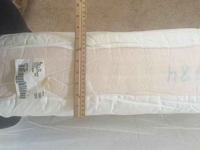

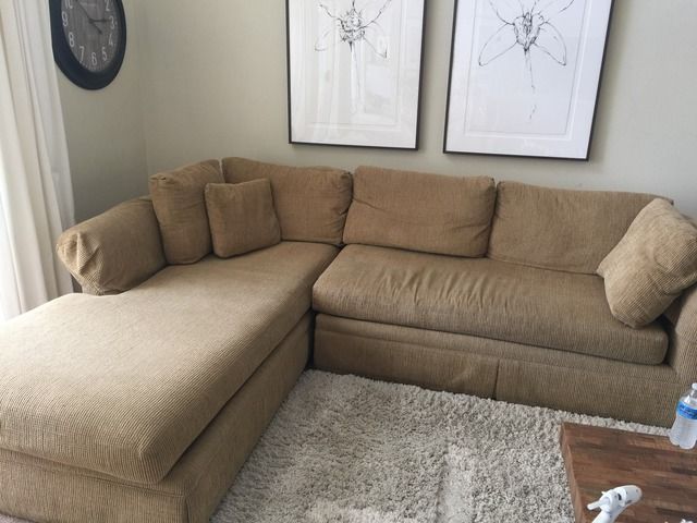

A couple questions if you don't mind....(attaching pics of my sectional below)
FOAM:
Do you agree that I should redo the seat cushions as even though they were good quality and vanguard calls them lifetime, they are 10 years old and the chaise sags in the center (not shown as much in photo) and sofa cushion is slightly compressed and sagging?
I know it's impossible to tell what density etc. foam I currently have but was wondering if you could give me your best guess for what it may be.  They are incredibly comfortable and I'd love to get close to the same feel.   The cushions are the Majestic style called semi-soft and they are described in this link from Vanguard furniture:
https://vanguardfurniture.com/CushionOptions

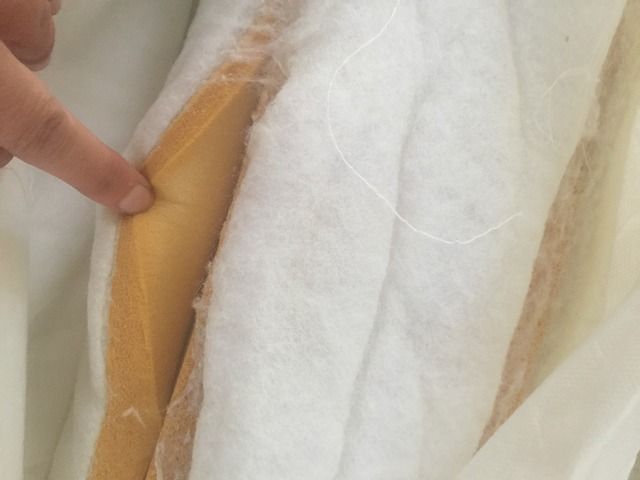

Upon opening the cotton sewn cover I believe there is a 5 inch high density foam topped by a 1 inch high density foam in, I am guessing, a softer foam than the 5 inch and then there is dacron on all sides.  The one inch topper foam is glued to the 5 inch and the edges appear to be pulled and glued down to make a roundish edge (could be the "comfort crown" described in the cushion description.   (box height of cushion covers is 5 inches). Any guess on what type of foams and dacron were used in this/or suggestions of what I should use?

If the cushions are collapsing and there is nothing wrong with the structure under the cushions you may need to replace the foam and maybe upgrade the foam.  Go to the upholster's shop and ask him to show you the different grades of foam.  This is all a matter of preference - those types of seating frames sit kind of low  This is about learning as much as it's about budget but replacing the seating cushions will add significant cost  -  the end result should be much better.  10 years is a good amount of time getting daily use and there is no mention how often or how many folks are using the furniture.  You thought this out nicely Mom and your description was even analytical but for a first project you may be pushing it.  A lot of expense on a big item like this may not be the right choice but I wish you the best whatever you decide.

Oh also there is also one spot that is ever so slightly depressed on the structure beneath the chaise cushion...there may be a spring out of wack...making the project even more out of my league lol....this should be interesting!  Also there are three of us in our home who use the sectional, my two children and myself.  Sectional gets a medium amount of use...not heavy tv watchers though and we are busy with kids activities etc.

A disconnected zig zag spring is an easy fix.  A sectional is a big project for a class setting.  Years ago I was the woodworker half with an upholstery team and we taught woodworking and upholstery to adults at night in a continuing education class at the local high school.  We did it for 5 years and never had a student bring in anything bigger than a wing chair.  With all that sewing for the cushion covers you will find out that you will spend time waiting for your turn on a sewing machine. Maybe time lost changing thread color.   It's a big project for a class setting but not impossible especially if the teacher approves.  And yes watching the teacher guide a student will take up a lot of your time but worth it - drink it all in - have safety glasses and maybe ear protection since there will be at least 4 staple guns going off at the same time and a compressor in the back ground.

As a whole this sectional looks like a big project. But when you break it down to three pieces its really not that bad. Everything is basically square. The cushions have no welt. The only thing that will be tricky is the skirt. Once your instructor gets you through the first piece the rest should go pretty smooth. You may have to finish it at home.
If Vanguard calls the cushions "lifetime" what does that mean? Some companies (Flex Steal for one) actually do give a life time warranty on their foam. That could save you a lot of money. It would be worth the research. Your instructor should be able to help determine if they need to be replaced. Sometimes a fresh layer of dacron helps them look like new.
Are you sure this sectional has springs? A lot of modern sectionals use elastic or rubber webbing for their support system. If this is the case there is a good chance they are stretched and sagging. When you take the black dust cover off the bottom you should be able to see what's holding the cushions up.

As for density, you must also consider compression. I prefer 2.7 density 35 lbs. compression. It has a soft, but weighty feel to it.

I had my eye on some 2635 foam that I can order online.  I am going to go to an upholstery supply store and probably buy in person instead so I can check them out and compare with what I've got.  I'll look for 2735.  Do you think the one inch topper is the same compression level as the 5" foam it's glued too?  Or softer?

If this was my sectional I would use a solid piece of foam and not worry about piecing the top. Glue a layer of dacron to the top front and bottom to give it that little bit of ahh.
