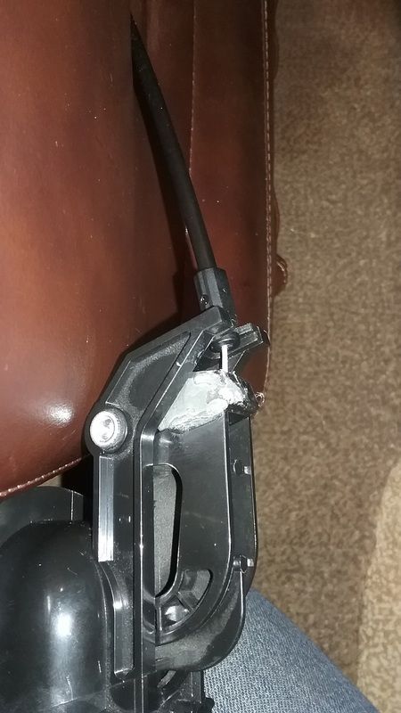

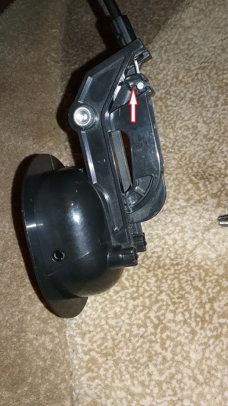

Service call to residence - Sofa w/recliners - handle doesn't raise footrest on one side.  Hoping it was just out of the slot - turns out one side of the plastic that captures the dowel pin was broken but the outside part of the plastic intact.  Sofa 9 years old - made in China.  I took the cable and handle off - With CA glue repaired the crack on the one bad side.  Roughed up the plastic in the cavity around the crack - put CA glue on the surface of the cavity than put a blob of plumbers epoxy in the cavity capturing the pin on the bad side and surrounding it with epoxy in place.  After that dried - more CA glue around the edges and put it all back together.  Nothing else I could think of to do to put it back together.  Maybe new handles are available but since this was my first handle/cable repair issue I had no spare parts with me.
If anyone knows a good place to stock up on recliner parts I'd appreciate the leads for the next time.  The repaired handle worked fine - should last a while -

I was thinking if I couldn't fix the plastic handle I would just drill the end of the cable into a wood dowel and leave the dowel hanging outside the recliner.  The ones on ebay with the ring on the end are reasonable remedies.   I guess if you had to retro fit a new plastic handle the opening could be altered to match in size but that is probably not worth anyone's time.  I notice those foot rests have quite a bit of snap when you pull the lever but I don't think it causes wear on the cable once the little lever is engaged which gets the big spring involved.

I went on Ebay and ordered a couple of cables - one with the ring as a generic and the other with the plastic inset lever handle.  The parts arrived a few days ago.  The handle / cable combo was the perfect match for the Bassett recliner handle I repaired a few weeks ago.  The cost is negligible for these parts.  I was in the house a little over an hour to make the epoxy repair.  It was a flat $ 200.00 charge - including travel.  If I had the replacement handles that I got off ebay recently I could have repaired the recliner in 10 minutes.  I'm ready for the next handle repair.
