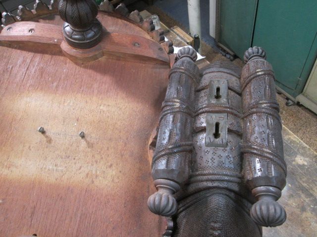

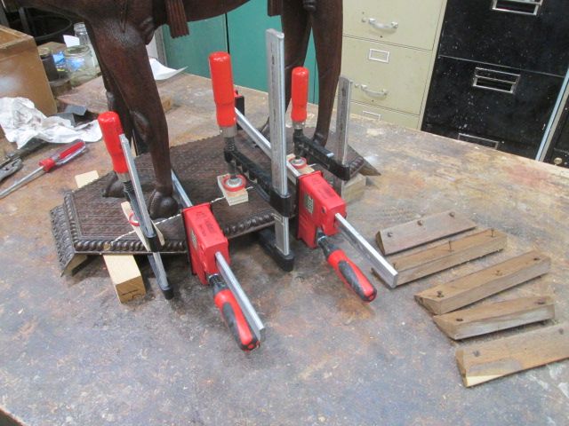

Took off the head and table - Clever how they are attached.  Had to remove the bottom moldings in order to get 90 % clamp pressure - just used yellow glue - I may add a couple of pocket screws after the glue is dry.  There are some bits of carving missing and need to touch up the repaired joint
The head is held on by a metal bar stuck in the neck. I know some folks who seem to have their buttocks held on by a metal bar stuck up their a$$. And of course I've never been accused of such a thing. :-)

The base is finally done.  After glue up I used Timber-mate to fill in some small voids.  Qualasole with earth pigments - browns and a tiny bit of mahogany followed by 3-4 spray can coats of clear flat lacquer.  Didn't need rubbing or waxing - looked just right.  Hope that's enough zoo animals for rest of the spring.
