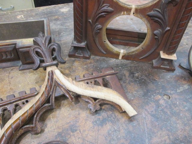

Started this last week - French clock from the 19th century.  Oak wood with time piece - coiled gong, and aneroid barometer.  Replaced missing curved trim on right crest - pieced in some wood to fill shrinkage on face area - and replaced one missing plinth support under the pilaster - stripping and sanding next

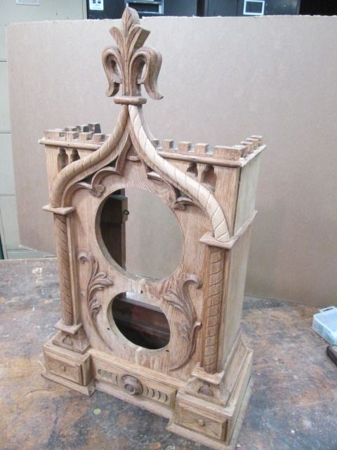

All stripped down and sanded - missing pieces replaced - ready for stain. Going to use a water based dye - golden oak strong mix -
Following the stain - one coat of shellac, followed by one mist coat of Beheln's gloss lacquer from the spray can, than 3 full coats of the same lacquer.  Clean the dials + glass, remount the time piece and barometer.  I think it's been returned to its original color.  The photos don't show the size of this clock well - it's over 24 inches tall.  I liked the castle architecture along the top -
