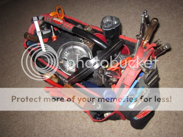

Some of you know I do repairs and not "in shop upholstery."   And I do all sorts of repairs from upholstery to frame repairs, electric and mechanical recliner mechs, and casegoods (beds, dressers, chairs, tables, doors, drawers, and finish repairs.   I'm visiting a daughter this weekend and installing some linen cabinets I made for her and brought along my traveling tool kit.   I wonder how it compares with what you guys have/carry.  Yes, it all fits in one Husky tote and though most things weigh only a couple of ounces, the tote goes about 40 lbs.
* Staple puller(s), I normally use Osborne 121 as I need to reattach fabric most often, not replace
* Spring puller (for R&R recliner mech springs)
* Awl
* Heavy duty scissors
* Fabric scissors
* Small pliers
* Multi-tip screwdriver (Pic-Quik)
* 35 pc GearWrench Micro driver set - complete set of metric & SAE socket wrenches, all types of driver bits -straight, slotted, Phillips, hex drive (SAE, metric added later), #2 Posi-driv (added), Torx. (fits any 1/4" drive bit from other sources)
- Utility knife
- Set of misc. shims, few toothpicks for loose screws
- 10" Vise Grip pliers, curved jaws
- Straight and curved hemostat grippers
- Needle nose pliers
- Pencil
- 4-in-hand rasp/file
- Set of 4 wood chisels 1/4, 1/2, 3/4, 1"
- 10 oz claw hammer
- 20 oz dead-blow hammer
- magnetic mechanic's dish
- Sets of SAE and Metric ratcheting box / open end wrenches
- 8" adjustable (crescent) wrench
- two 4" F-clamps
- Painter's pry bar
- Nail pulling bar/pry bar
- 10 water pump pliers (e.g., Channellock)
- "Extractor" nail/staple puller
- Set of nail sets, center punch
- Hearing protectors
- Mechanic's gloves
- Small waist apron for holding tools/parts
- Flashlight
- Circuit tester (yes, I have found recliners that didn't work because the wall outlet was dead)
- Mirrored inspection tool
- 12' tape measure
- 6" calipers
- Magnetic pick up tool
- Grabber pick up tool
- Extra long slotted screwdriver
- Folding square that goes 135, 90 & 45 degrees
- 4" combo square
- Japanese pull saw (Shark saw carpenter's)
- Small can 3-in-1 oil
- Small bottle of wood glue
- Screw lube
- Bar of paraffin wax
- 12" cable ties
- Mechanic's hand cleaner
Often use auxiliary "drill box" containing
- 12v. cordless drill with extra battery
- set of twist drill bits
- Kreg jig K3 and mini
- countersink bits for #10 and #8 screws
- self centering hinge bit (vix-bit)
- variety of driver bits, mostly #2 phillips and square drive of different lengths
- 90 degree driver attachment
- Selection of 1.25" and 1.5" pocket screw screws
- Vice grip pad clamps for holding pocket hole jig & joints
- Stripped screw extractor set
How does yours compare?

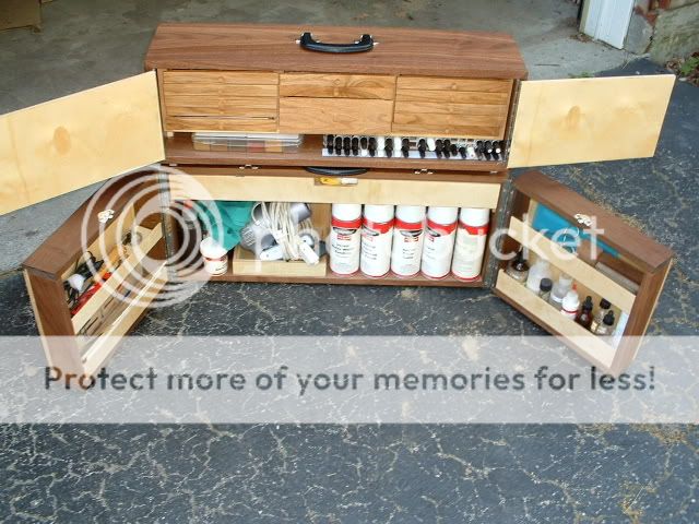

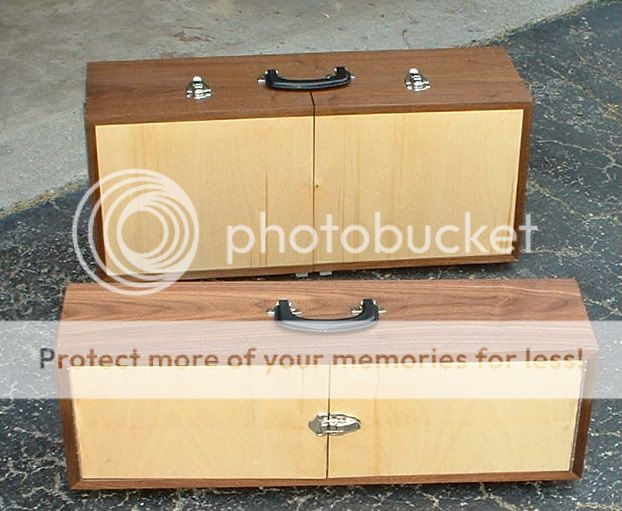

I found some photos of my touch up kit.  I got a box with my original kit, but was never very happy with it.  Then when my supplier re-did their product line and added stuff, I decided to make my own.   Looked all over the place for an off-the-shelf model -- mechanics, old time carpenters, fishing, other vendors, nothing I liked.  So I laid out my kit, measured and counted everything, decided on two vs one box, and started the build.  Took much longer to decide what to do than to just do it.
Nice boxes, nothing like custom made.
