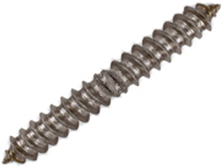

Three other options, preceded by sawing of the leg as flush as possible first, and drilling a pilot hole in the stub that's left.    Any of these enable a screw-on leg.
1.  A dowel screw, sort of like a hanger bolt, but with wood threads on both ends:
