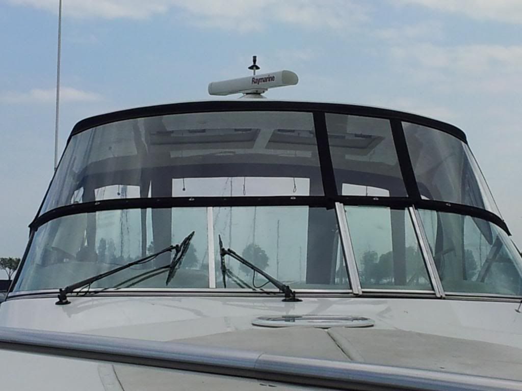

Suzi that whT i  did here.  On top one continuse   kedar with a 3" or so flap with a zipper cor each window. I put velcro also to hold the flap down i. Wind and turn buttons on. Ottom or lift the dots
http://i782.photobucket.com/albums/yy102/Mike8560/Flybridge/100_1160.jpg
