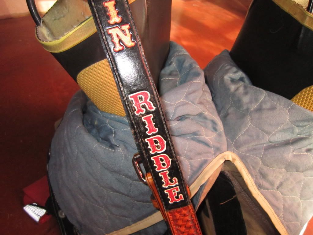

Oh, I forgot to show you a couple of leather pieces!  Here ya go.
First gun holster.  This is for my 40 Springfield XD Subcompact.  The first 2 are wet forming.
First knife sheaths.
This is Python inlay.
This is for a Gerber Multi Tool.

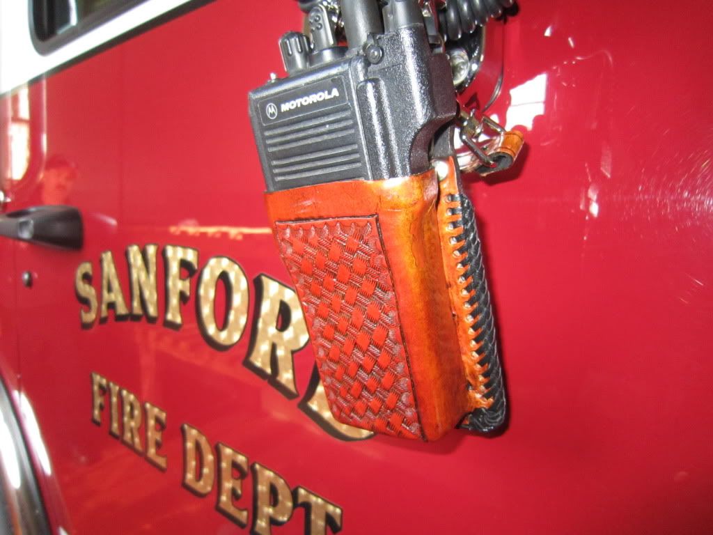

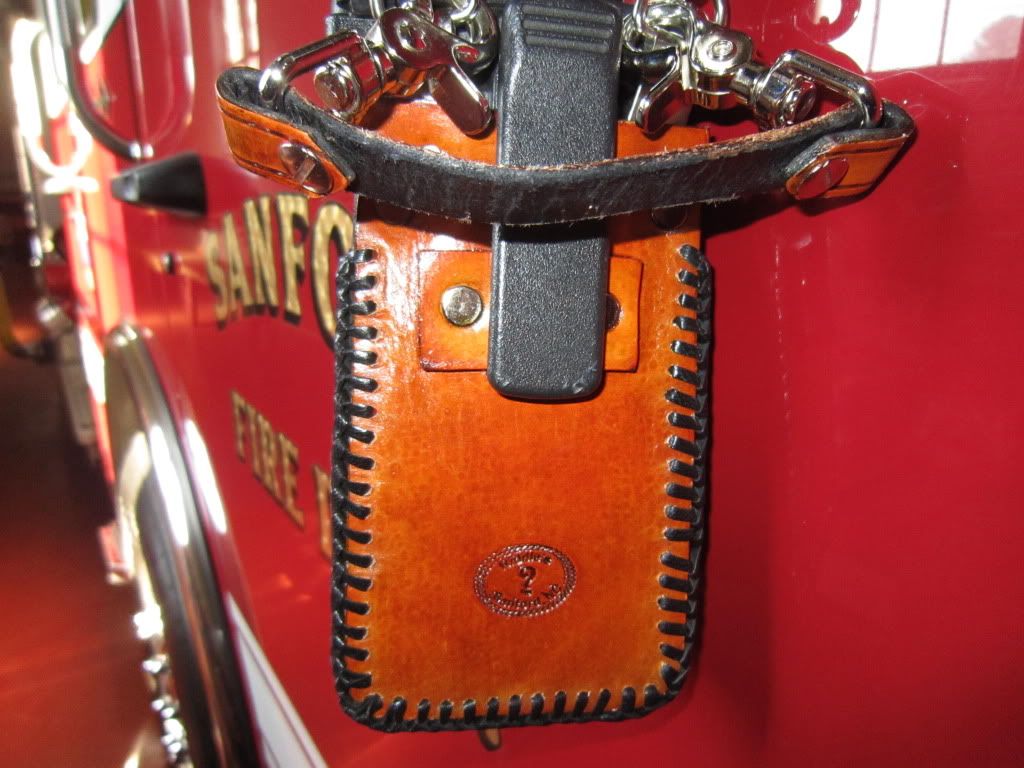

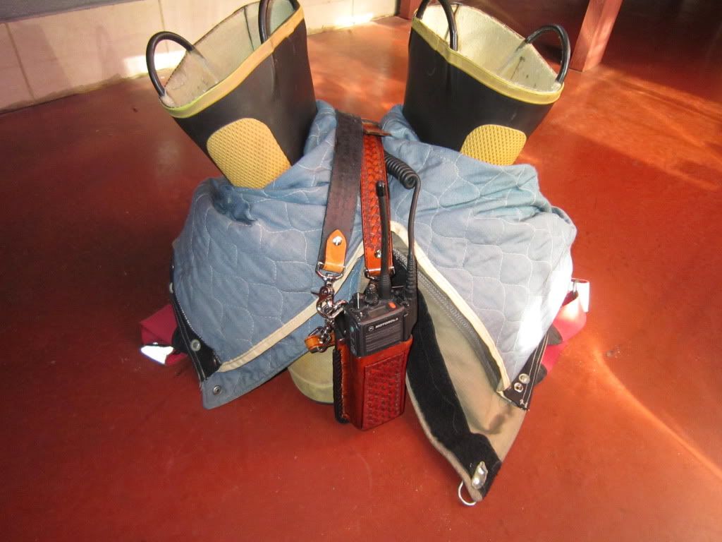

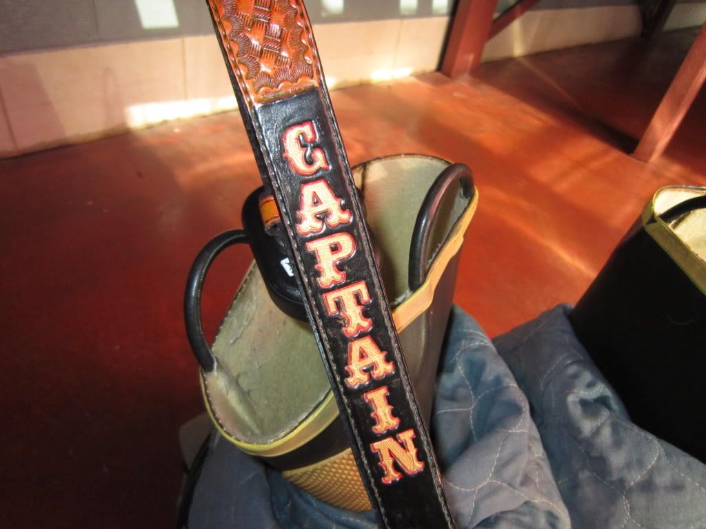

This is a radio strap and holder I made.

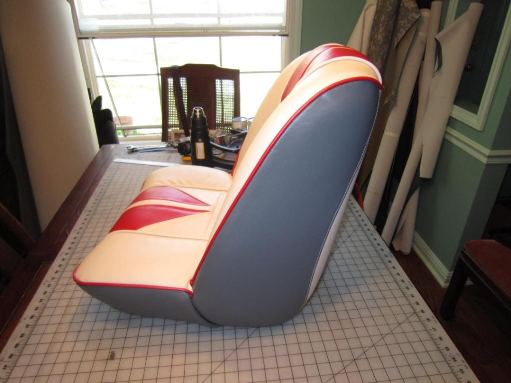

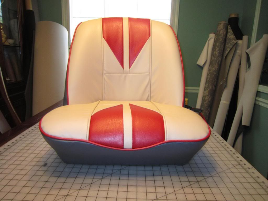

While looking for some leather pictures, I ran across some pictures of my first boat seat.
