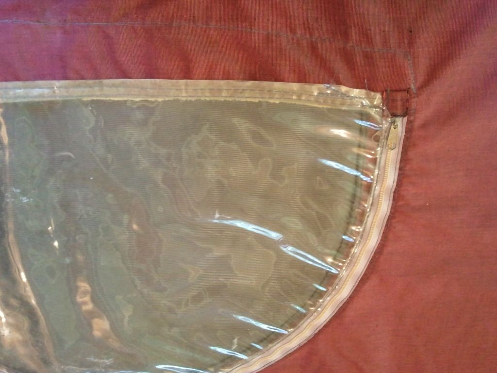

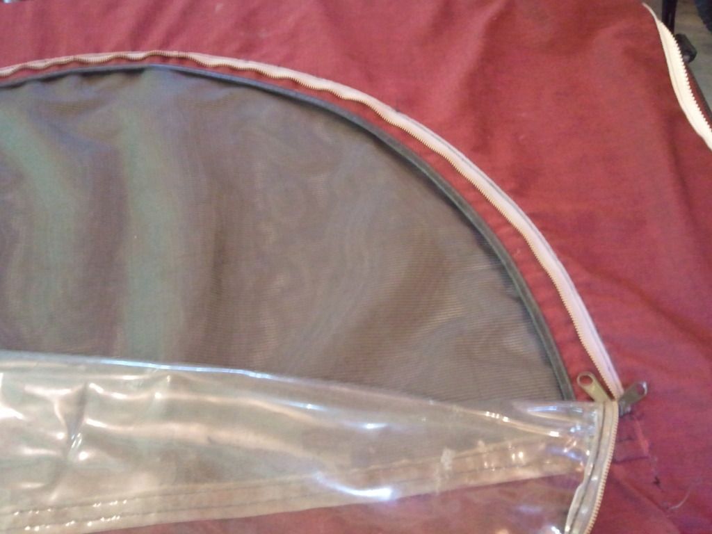

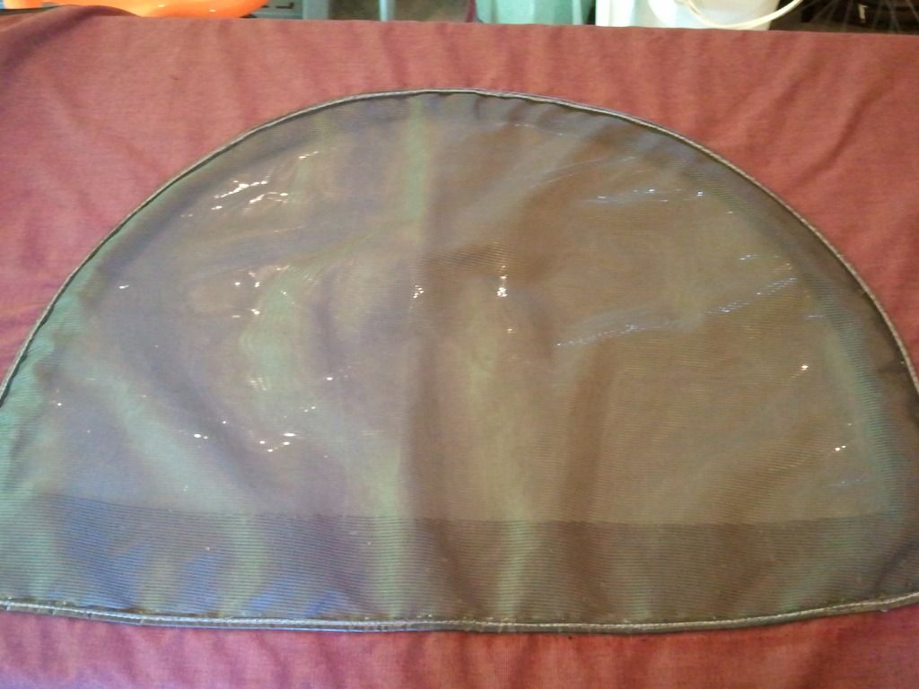

I'm trying to duplicate these panels (minus the wrinkles, of course). Never done this type of thing before. Here is the outside view of the mesh.
Here's the inside:
and the view under the zipper:
So how do I start? Cut out the shape in the canvas first, or sew down the mesh first and then cut out the canvas?
Also, you can't really tell from these pics, but it just looks messy all over...too many stitch lines on top of each other, ugly raw edges on the inside, weird small metal zippers.
It looks like they cut out the mesh shape, then bound the edge then sewed it down on the outside. It seems so convoluted. Is there an easier way, and if so, does anyone have some photo examples I can copy from?
Thanks so much!

My problem is getting the screen thing right. I just tried to bind the mesh, and it didn't work out - wavy edges.
And then there's the cut out thing.
