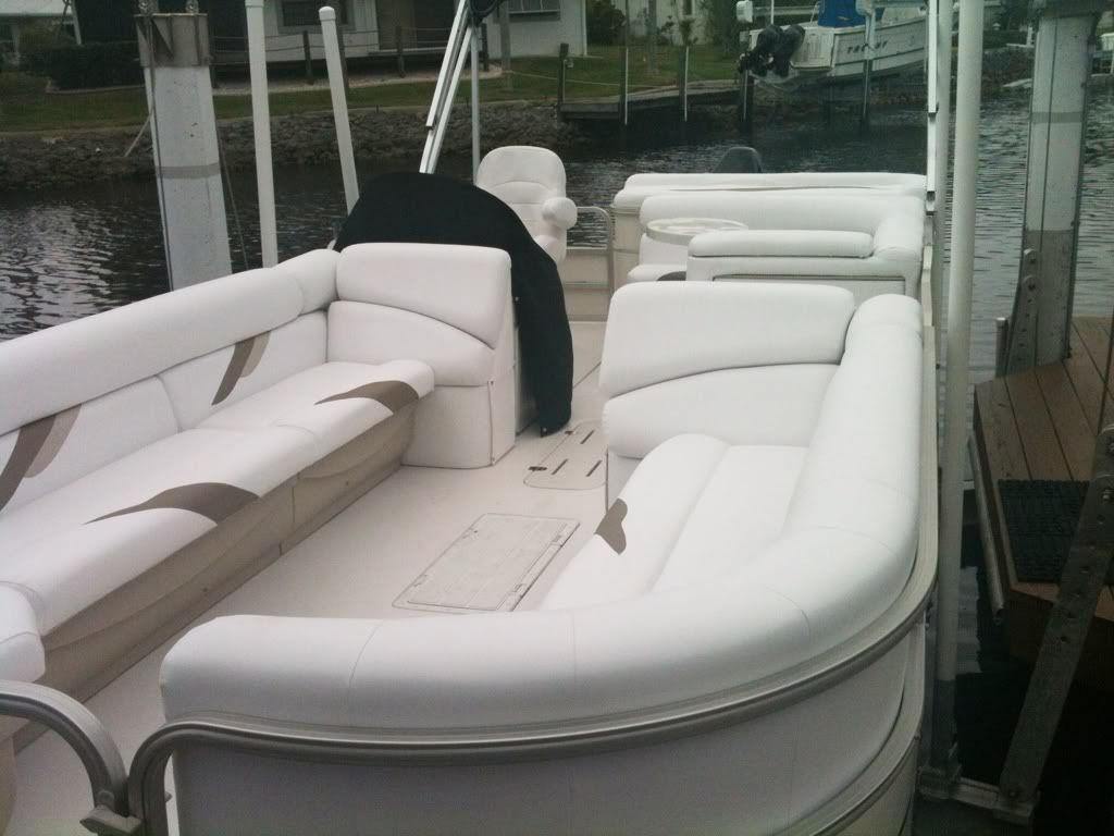

June 20, 2012, 10:20:37 am #7 Last Edit: June 20, 2012, 10:23:10 am by MikeM8560
Plastic bases seats and backs only. 4 days.
link
Plastic bases whats seen plus two folding fishing seat up front
3 days
pic
Mike, your work is an inspiration.  Just beautiful!
