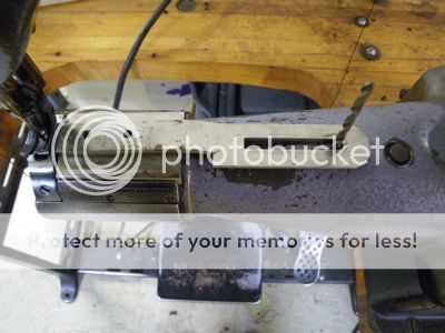

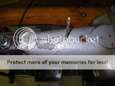

I ended up with an old Singer 153k101 walking foot cylinder arm machine that came with a box of attachments including a right angle binder setup.  The binder itself mounts on a modified bobbin cover slide plate (part #221174) that has two holes for the binder to screw onto and a welded on slotted 6" narrow plate that extends along the cylinder so that the slot aligns and ends above a hole in the cylinder arm that is 6" from the needle (this is not an oil point).  It looks like this hole should be threaded and a screw would go through the slot to hold the back end of the binder plate stable (while allowing it to slide and access the bobbin).
The hole (size 17 drill) is not threaded, however.  Does a missing pin or something go in there to hold attachments stable, or am I supposed to tap it myself ( a size 12-24 tap would fit)
Anybody out there familiar with this machine and know what that hole does?

Lets try this since the regular upload path is blocked.  Sorry the picture is small.  The hole is centered on the arm although the picture distorts that.
First is the hole with a drill in it to mark it
second is the binder arm on the machine (without the binder itself mounted) again with a drill marking the hole
Seems a screw should go in that hole, but then why is it unthreaded and how do I stabilize the plate using that hole?

Gregg @ Keystone Sewing
March 27, 2012, 06:56:53 am #5 Last Edit: March 27, 2012, 07:01:18 am by Gregg @ Keystone Sewing
numbskull,
I just check machines I have here in stock...most close related I have in stock Singer 153W101.  In this hole where first drill bit is located (mounting hole for your custom binder attachment to bed of machine) is a is threaded hole that uses Singer attachment screw tap 13/64-32.  This is a common sewing machne screw that is not Standard, SAE, or metric.
Check this hole, the threads could be covered in dirt, paint, or anything else you can think of.  Blow it out with compressed air, scape lightly with a screw driver or the such to see if there are threads.
numbskull
Thank you, Gregg.
The hole on my machine is not threaded but obviously it should be or can be.  Maybe they missed it on construction or maybe it was usually done after sale only as needed.  Anyways, knowing that it is threaded on other machines gives me the confidence to just go ahead and tap it.  I'll check with my machinist friend to see if he has the right tap.
Thank you again, your willingness to help is greatly appreciated.
