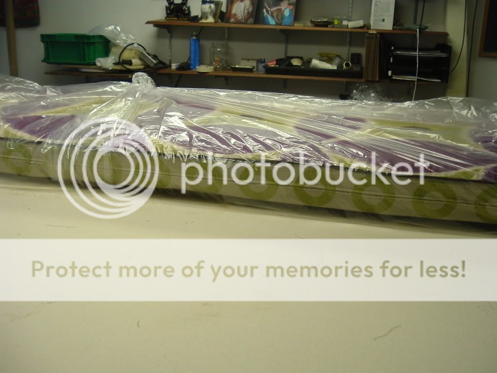

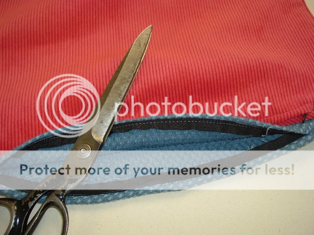

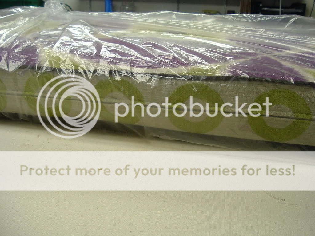

Here are some pics that I hope will help with what I am saying. Two are the back of a boxed cushion. You can see how the two equal flaps hide the zipper.

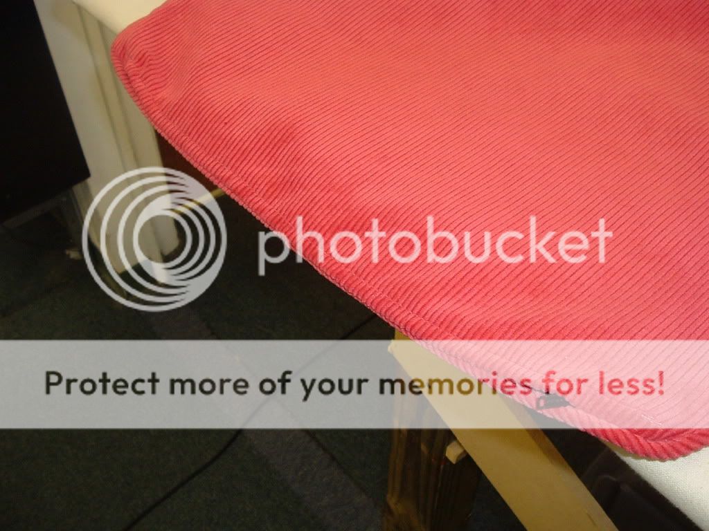

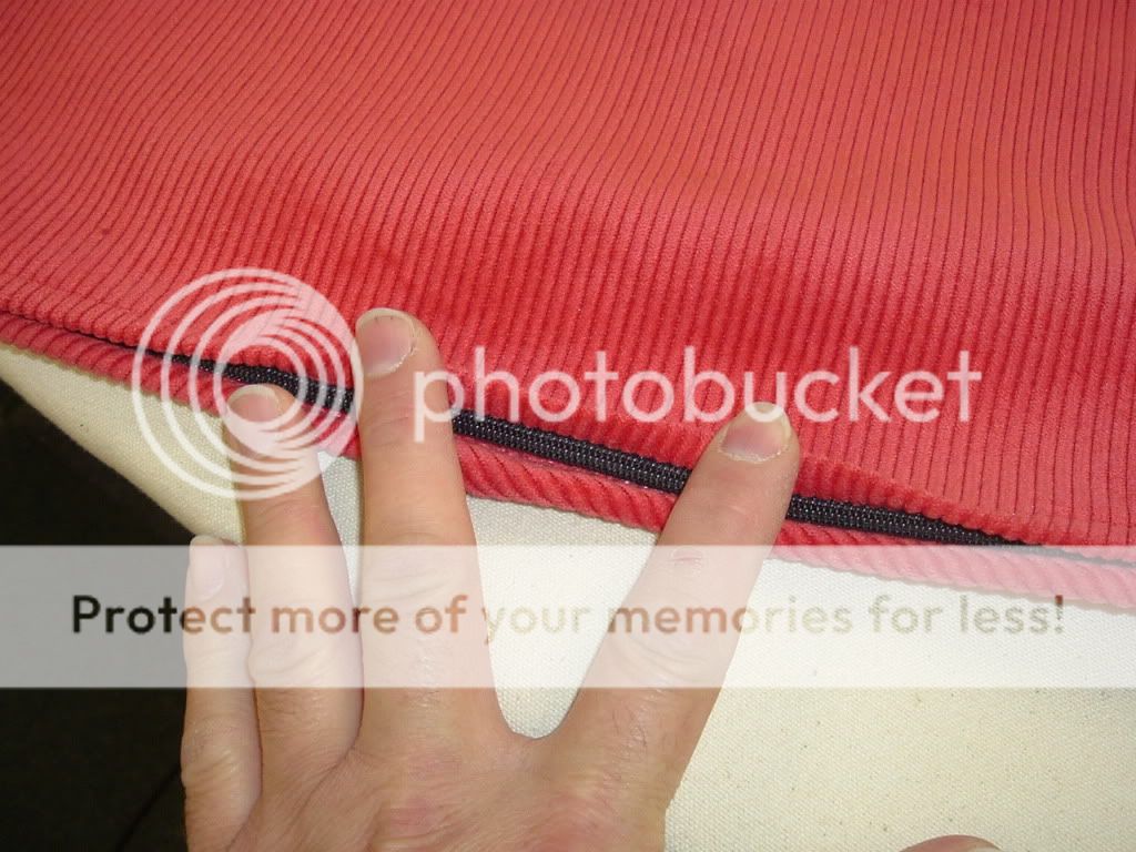

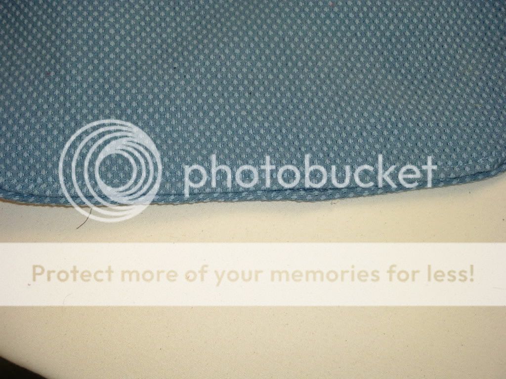

The other pics are of the back of knife edge, self welt pillow covers. The 3/8" flap that I mentioned is the part between the zipper and the edge of the pillow. This cover the zipper when the zipper is closed.
I layed the pink pillow cover on the blue one to help show the blue one better. I hope this doesn't get things confusing.
<a href="http://i830.photobucket.com/albums/zz228/genejoe/3-12/DSCF2379.jpg"; target="_blank"><img src="http://i830.photobucket.com/albums/zz228/genejoe/3-12/th_DSCF2379.jpg"; border="0" alt="Photobucket" ></a>
<a href="http://i830.photobucket.com/albums/zz228/genejoe/3-12/DSCF2378.jpg"; target="_blank"><img src="http://i830.photobucket.com/albums/zz228/genejoe/3-12/th_DSCF2378.jpg"; border="0" alt="Photobucket" ></a>
<a href="http://i830.photobucket.com/albums/zz228/genejoe/3-12/DSCF2384.jpg"; target="_blank"><img src="http://i830.photobucket.com/albums/zz228/genejoe/3-12/th_DSCF2384.jpg"; border="0" alt="Photobucket" ></a>
<a href="http://i830.photobucket.com/albums/zz228/genejoe/3-12/DSCF2382.jpg"; target="_blank"><img src="http://i830.photobucket.com/albums/zz228/genejoe/3-12/th_DSCF2382.jpg"; border="0" alt="Photobucket" ></a>
<a href="http://i830.photobucket.com/albums/zz228/genejoe/3-12/DSCF2381.jpg"; target="_blank"><img src="http://i830.photobucket.com/albums/zz228/genejoe/3-12/th_DSCF2381.jpg"; border="0" alt="Photobucket" ></a>
<a href="http://i830.photobucket.com/albums/zz228/genejoe/3-12/DSCF2380.jpg"; target="_blank"><img src="http://i830.photobucket.com/albums/zz228/genejoe/3-12/th_DSCF2380.jpg"; border="0" alt="Photobucket" ></a>
