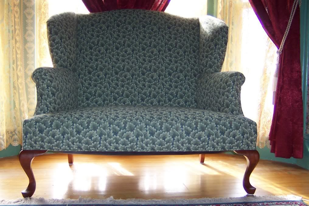

Hi Gene:  I go the the Chiropractor when ever my arms start falling asleep when I am trying to sleep.  Usually fixes me up for about 6 months.  I have a wing back settee similar to what you mention.
Not the best picture, but everyone "just loves it" if I only had a dollar for every time I heard that one.  Supposedly I have this one sold, I sell far more wing chairs than wing back settees.
