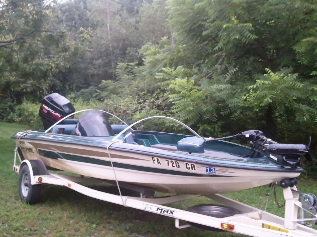

So this is my next cover project:
I've never done one like this...what do you do when you get to the trolling motor? I think the propeller flips to the inside?

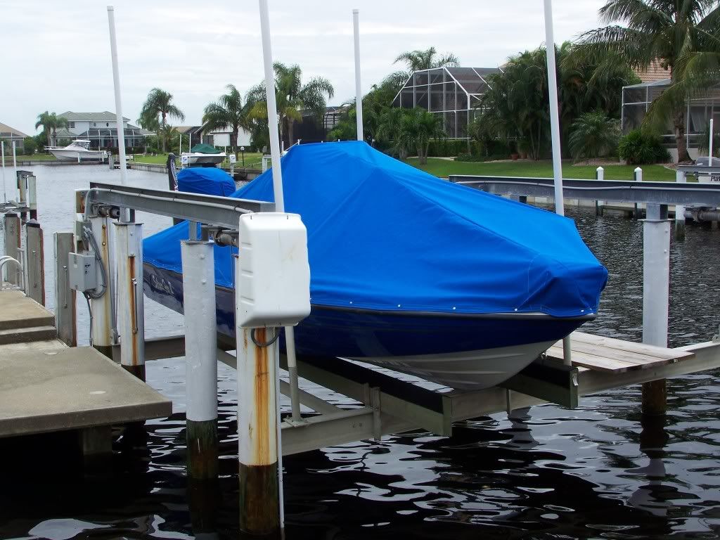

I hate them really screww up half patternga boat
I just usualy go over it and reinforce the motor prop area
so
times I've gone under around them but nit mane and then had a seperate cover
http://i782.photobucket.com/albums/yy102/Mike8560/covers/100_1363.jpg
Thanks Mike! The photo is really helpful.
The customer wants the snaps under the rubrail, but the rubrail is all rubber, so they have to be a couple of inches below, which means my cover won't look as good as yours  :(.
