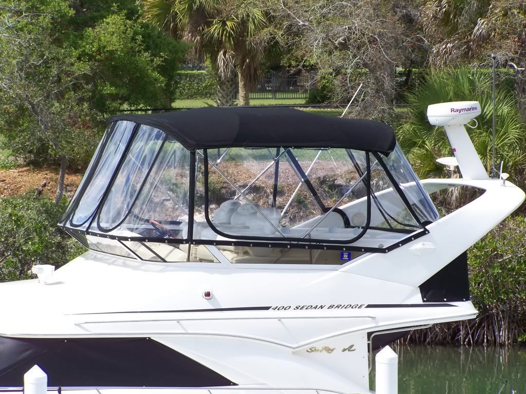

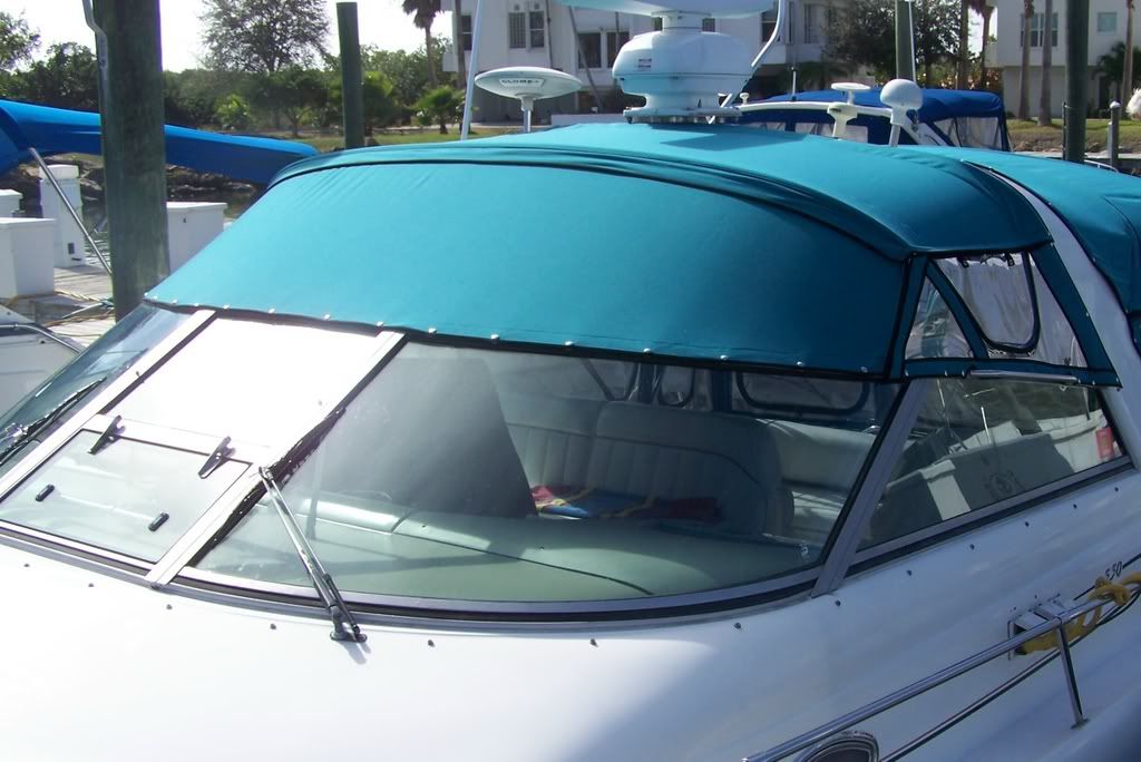

like I said before I have more allowance (push) in the center of the bow were it is weaker and on the corners where the frame is stronger I have less where the frame can really pull the top tight with the strap or support leg  anyway here are two shot that show how my curves turn out

Looks great Rich! Nice job.
Peppy....I think you've got it. Yes, the tube cross section does change and easing the end of the pockets helps a lot.
