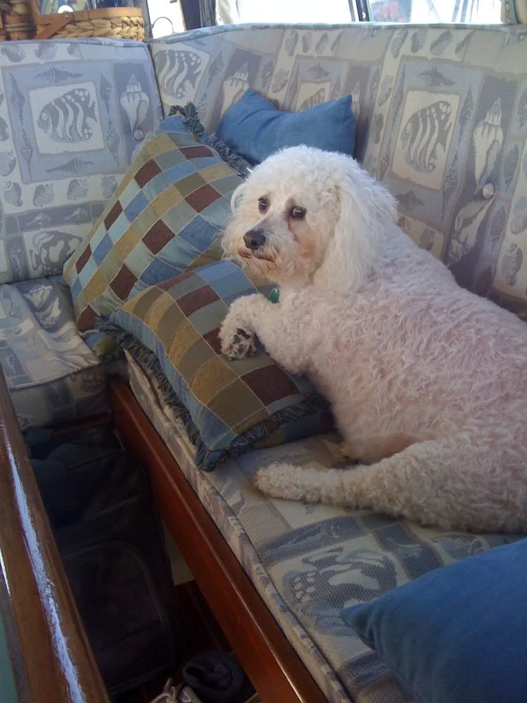

This prompt won't help but I don't use a welt foot ever I did this sette on my last boat 5/32" polyfoam and sunbrella fabric   Ignore the dog
http://i782.photobucket.com/albums/yy102/Mike8560/BLue%20Dolphin%201/img_0999.jpg

Quote from: Mike8560 on May 30, 2011, 05:12:51 am
How can we ignore the dog,  aarrh. I am sure we had the same material on our boat  ::)
