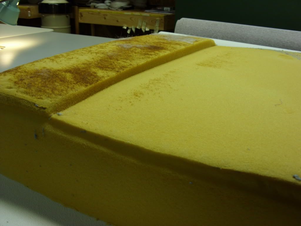

Ok, here's the Tiara helm seat.
The foam
The skin inside.  Note the mesh pull/listing/whatever sewn into the center seam.
The skin outside.
Put skin over foam that is still attached to board, staple mesh pull along the foam/seam line.  Here's where it gets critical to pull the same depth all along the seam.  The top will be all up/down if the tension isn't consistent.
Put loose piece of foam back in place, pull vinyl around to the bottom and staple.
The seat back is not stapled (except for the pull).  It's a complete cover with a zip along the bottom.  Here's the vinyl pulled over and the center pull stapled in place.
The aluminum arms are inserted through the skin bottom and screwed into place.
The bottom section of foam is put back in place and the opening zipped closed.
The finished seat.

Bobbin, I like mesh for the pulls because it doesn't restrict water flow.  I've opened up too many cushions where the pull was vinyl and the water inside never got a chance to drain.  The mesh is strong, doesn't react badly when I have to pull out/reinstall staples because I got the position wrong, and permits the water to flow to the lowest point which aids in drying out the foam.
