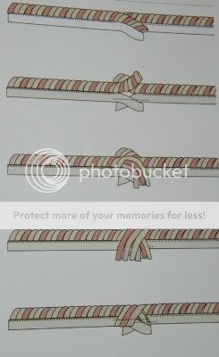

Some folks have asked about this in the past. I came across this photo. This is how I do it. I always put tape on the end of each cord so it does not unravel.
One critical point is how you cut the lip. This picture does a good job of showing how to cut the lip. Get that right, and wrapping the individual cords over each other is rather easy.
I do love it when I do it right. For me it took practise.
Good luck,
http://i830.photobucket.com/albums/zz228/genejoe/boat/65932562.jpg
I never knew how to do that, Gene!!!
And it's always bothered me to do a crummy, bumpy job of it.  I was always afraid to "unravel" the stuff but now I'll be all over it.
You rock! and now I'm not afraid to just go for it.
