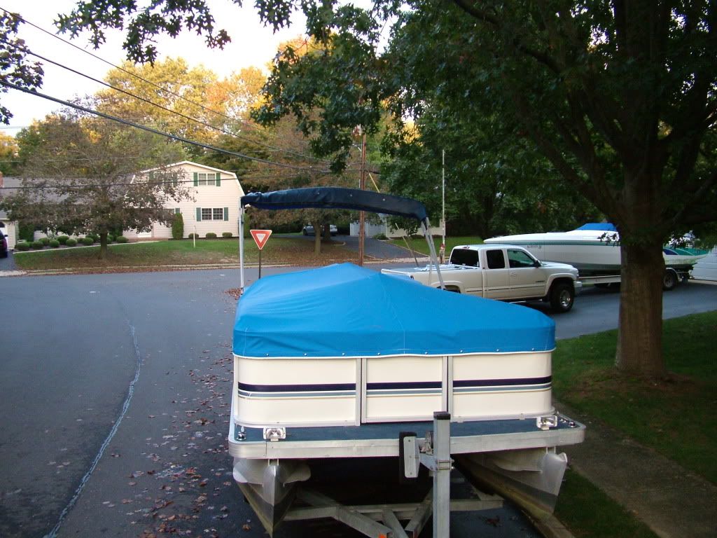

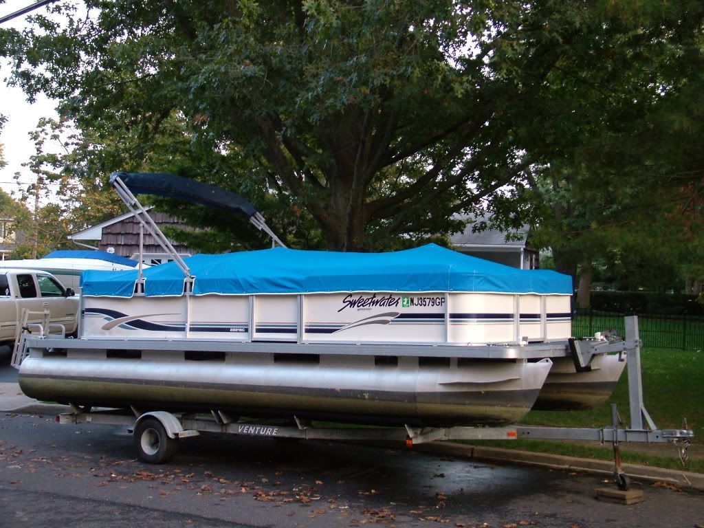

December 12, 2010, 09:19:40 am #7 Last Edit: December 12, 2010, 09:33:57 am by scarab29
Here's one I did this fall. Material is toppesey w stamoid binding on the edge. Seam down the center ,  3 tent poles and worked great to keep the water from pooling anywhere. I liked the topessy , lighter weight , nice look like regular acrylic on the outside and a heavy waterproof coating on the backside. Too bad it's going away !!
http://i758.photobucket.com/albums/xx227/scarab29-photo/DSCF3987.jpg
http://i758.photobucket.com/albums/xx227/scarab29-photo/DSCF3988.jpg
