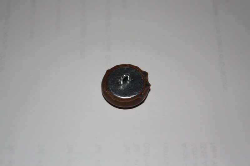

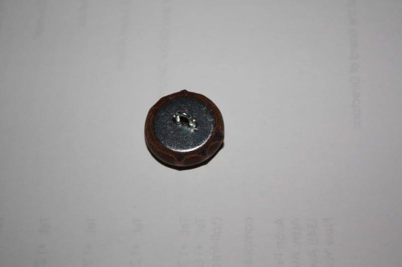

Anyone have any suggestions on how to make vinyl buttons without the vinyl separating from the backing.  I have tried heating the vinyl, using a backer fabric, lubricating the vinyl and molds all without success. I am using standard duty molds.
Thanks
Mike.
