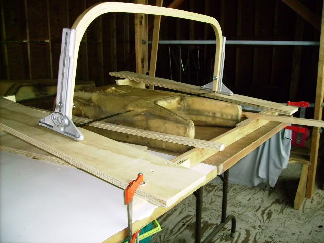

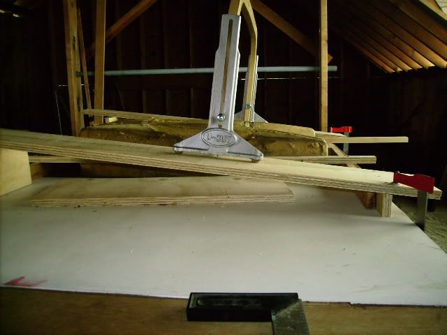

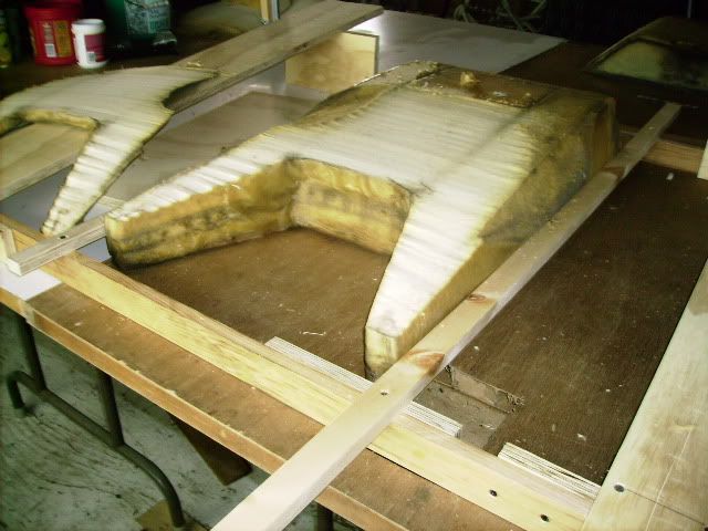

I've been busy playing with it & here is my rude jig, sofadoc. Basically it's ramps with the angle of the cut that the saw slides on but it works pretty slick! I thought of making it adjustable, but no need right now. I f you don't have another pair of hands to help you out make sure that the foam is in tight for cutting. I found that I needed the foam to be in the center of the ramps for the best control of the cut. My ramps are a bit narrow-I need to widen them & I think the "jig" will be done. This basic model works for me & I have not needed to spray it with silicone yet. All that's needed now is to finish shaping it with the grinder & sander.
the price of this varied greatly from one vendor to another-i got mine at actionupholstery.
Pretty slick! Glad the saw is working out. On real dense foam, you probably won't need too much silicone ( at least as long as the blade doesn't get dull ).
Your pics on photobucket are first rate.
From the photos of the jig, it looks like you are making short strokes. Right?
penguin
thanks sofadoc! And yes-short strokes with the saw- that's why I need to widen the ramps a bit-I fell off of them a few times before I got the hang of it. I've got plenty of scrap wood around so I'll keep tweaking until I get it where I need it.
