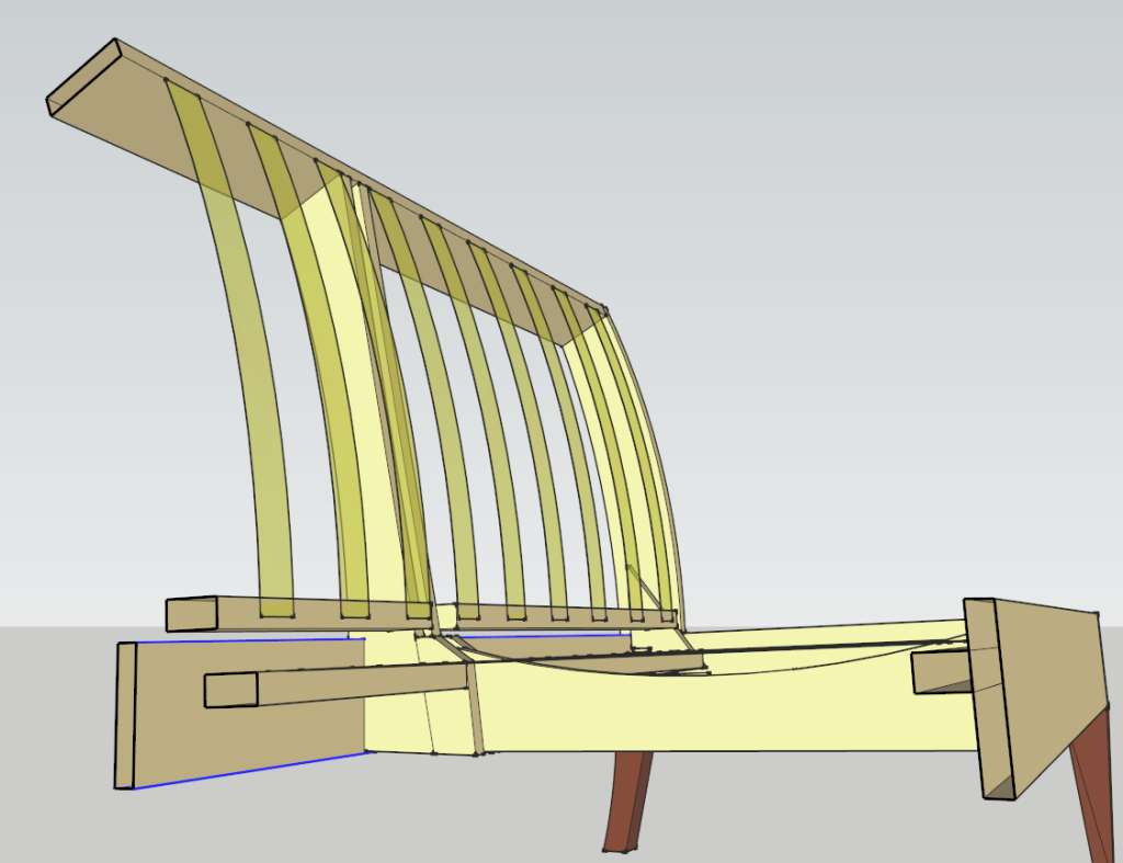

You still need a bottom rail that will create a crevice for your padding and fabric to pull through and staple. Am I making sense?
You don't want the back webbing to go all the way to the seat deck.
Boxduh
OK, we are getting somewhere.
I raised the rail part that picks up the bottom ends of the ziggys for the back.  Here is a back view.
And a section cut.  You can see the two rails inset down into the seat box to pick up the ziggys for the seat platform.
So is this getting close to right?
I'd say that you're pretty close.
It's possible that this curve isn't cut out deep enough. If you're going to use webbing in the seat deck, you'll probably still feel this board when you sit down.
But overall, I don't see anything else that your upholsterer can't work with.

We're dang close to excellent----BUT, I'd like to toss in a couple of thoughts;
Plywood vs. dimensional hard wood ( or > 1.5 X measurement soft wood);
     > As Kieth said, go big or go home on the spring rails. The ones  I have to repair on a usual basis are usually too small for the task and/or have knots.
     >I have on occasion been forced to reinforce the warped spring rail with angle iron on the corner that still allows all stapling. Even 3/4X3/4X 1/8th would be sufficient an save trying to find acceptable hardwood if you wanted to go all plywood. I like screws to fight gravity and stove bolts to fight the springs. Stagger the holes in the angle iron of course.
Load bearing;
     >I would rotate the bottom spring rail in the back as Keith pointed out.
     >That frame member across the bottom of the unit---I would lay on it's flat instead of on edge. It's not really load bearing (although it "helps" keep the frame from warping) , so turning it increase what it does, allows easier access to the spring rails for your upholsterer, and gives you a wider footprint to mount legs.
Spreader cut out;
     >Yes will need to double check that before you go too far, but it can be trimmed in place before you attach the deck.
     >If I 'm using furni-web, I double up the webbing next to the spreader an crank it a little tighter. By that I mean 2 strips side by each like a pair of toast, not folded.
