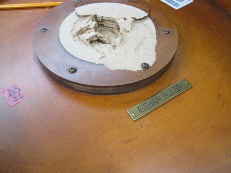

This table just came in a few minutes ago.  Made out of paper and wood.  Ethan Allen should be good quality right ?

Hey Doyle - always nice words from you - Thank You.
It isn't a stool - it's the Ethan Allen Pineapple Table.  Not valuable - made from wood and paper.  The support piece that the top attaches to was torn apart.  I glued the layers together and filled the voids with bondo glass.

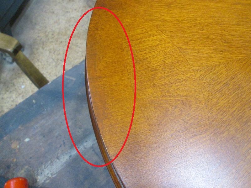

A foot was broken off I re-glued that and touched up.
The harder part was a damaged top surface.  I forgot to take a before photo but the top had a 4 inch x 1/2 inch piece of veneer broken out from the edge and the veneer lost.
I filled with regular bondo - further filled with timbermate - slowly built back the coloring without going too dark.  I highlighted the areas so up close you can see the repair when you know where to look - otherwise no one will pick out the fill in.  The finish was satin lacquer and I rubbed the whole top so all would blend.
Awesome job on the repair Steve. Its amazing what furniture is made of these days. What really cought my eye in your photo is the eliptoid inlay to the right of the repair. Does that pattern repeat around the table.
Yes it does have an elliptical inlay along the edge.  The lighting in the shop was casting shadows and a certain amount of chatoyance can't be avoided.  Here is a photo outside on my way to delivery
