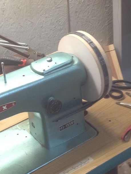

I made this 6 1/2" handwheel for mine.  Slowed her down to about 1/2 speed.  I also adjusted the clutch so it engages at the very touch of the pedal.  SOOOOOO much better.  Wheel is made from Cheap MDF Took 15 minutes to make it using 5 minute epoxy and my wood lathe.  I've made several for other "Stitchers" and they all love em.  If you need help with one, contact me and I'll lend a hand.
