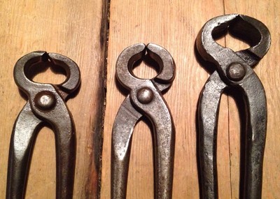

or carpenter's nail pincers (nippers) like these

It's the carpenter's pincers I use. Thanks for posting the pic---I forgot to take one at work yesterday to post.
