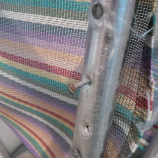

Exisitng attachment is like a spiral nail that got driven into the aluminum.
Anyone tried to remove and reuse these type of fasteners?
Also open to other simple solutions
Haven't seen one with a screw like that.  I guess you can't get it to retighten ?  Have you ever used self tapping sheet metal screws ?

The screws did go back into the replacement mesh material and seemed to snug in. I probably should have used a small shot of glue at each nail. I think if they have no chance to move relative to the material they will not work their way back out.
Could definitely sit down and get up out of the chair a few times without anything shifting. Also laid in some duct tape on the underside to help keep things in place.
or maybe a dot of silicone glue where the material touches the frame
is this for yourseld? I ufuse to do this stuff for customers they never want to pay what its worth and you always got problems   id try attachinjg differently like rivitinf on maybe with a flat bar or lacing with grometts in navy canvas would have a nautical look too
