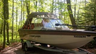

Just how much of a pain is it to pattern the drop/curve in the cover where the canvas meets the plastic on the front? Any advice.
I can pattern from the bow to the windshield edge with pattern material, but that will give me a straight line between not the dogleg drop that you can see in the picture.

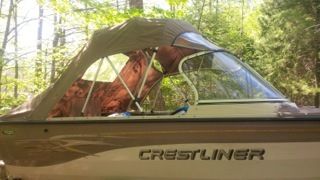

Additional question? would 20 or 30 g plastic be better for the front clear portion where it attachs to the windshield?
  Now that's a neat concept there, The zippers and sealing for the walk thru roll up a pita.
I believe 30 good stuff at least, because the angle of clear is in a tough situation, and its flat when new as I think the sun heat put the curve in it. On the corners I think they will fall pretty nice going on down and around to meet the straight angle up.
Something I would consider a re-look at is angling the forward bar a bit more if needed so it is in a pocket @the rear edge of a bit more strataglass and canvas say overlaps the bar 2" with glass under a ledge will say.

If the was doing it , i would template from the front bow, make a 2" or so down flap where you can attach a zipper or three, and template the plastic straight off the front bow to the windshield. Run straight lines from the corner of the windshield up. This will give them more visibility as well. Nothing personal but that is one ugly boat cover. Lol
im not folling the question  "drop/curve in the cover where the canvas meets the  do you mean the windshield of the plkastic window in the canvas top?   it pattern in canvas with no plastic window who wants the hot sun on your head unless you sit so hight you need the vinyl window   and as far ans the oddball side window now needed with the curvy window id have made the top come down farther to the side to come in line with the side angle of the windshield.

A line from the front bar to the windshield is NOT straight. There is actually an angle of the canvas to the plastic that is simply formed by the material.
There is a slight gather in the canvas across this seam that i think is going to drive me insane.
Right now I am going to try to pattern with a mockup in pattern material sewn together between the front bow and the windshield.
If you look at other crest line sea hawk fishing boat images on google some look even stranger.
Your the boss, Im pretty sure though when they made it they patterned it as yes 2 angles going forward I didn't say it correct, 1 the boats windshield and 2 the tops front area.
That "side to side" top curve where the clear is connected is the spitin image of a typical rear convertible and Im not sure I would have done that. "Unless"
To my eye it has more bow than the factory bars and looking like a dodger bends, this im not sure why without fiddling with it and being onsite.
The tops are great for rain and inclimate weather I totally understand cover on the water btdt. love aluminum boats to, we have many rivers with rocks.
I would consider that front bar to be way more of an angle towards front as this I think is what will keep it from doing the exact same thing, its possible the bar should be and is the same curve as windshield looking from top down, but if its not angled enough/pushing forward  well ?

The shape of this cover is different.
Looking back, I wish I had seen the old cover on the boat so I could have asked the customer if they wanted to keep that shape. I priced the cover with it off the boat sitting on the ground.  I did not pick up on the strange shaping at the time. It was in such bad shape that I do not think my customer had used it for years.  But hindsight is wonderful.
