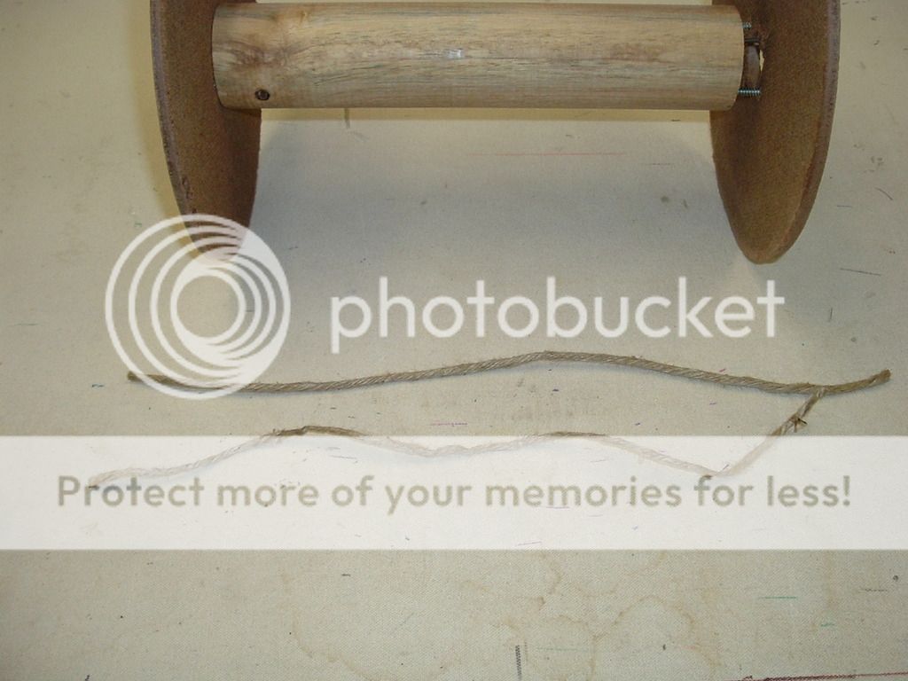

I've bought jute cord and used it for my welt cord for the last 11 years. It came with a wooden core. I bought another 10# roll and didn't notice that it did not have a wooden core until I went to use it today.
The top piece of jute webbing is what I have used for the last 11 years.
The bottom piece of jute webbing is what they are selling me now and telling me it's the exact same size. Yea, right.
Their new supplier is saving money by eliminating the wooden core AND by making the jute cord half as thick.
It's like when they stopped making 2 x 4's 2" x 4".

Its looks like they at the manufacture have someone turning the screws a little loose after the quality control person leaves the site, as that on the bottom looks flat and loose.

March 15, 2015, 06:30:16 am #5 Last Edit: March 15, 2015, 06:32:22 am by gene
Dennis:
About 60 to 65 yards per pound for 5/32" jute welt cord.
Sunshine Foam prices, all 5/32":
Tissue welt cord which I think is your fiberflex: .0479/yard. This is a stiffer welt cord and I cannot use it with some thinner fabrics. I use it with all slipcovers because it will not shrink if washed.
Cotton welt cord. .0665/yard
Jute welt cord. .054/yard
The cost of jute welt cord has continued to go up over the years, passing the tissue price and getting closer to the cotton welt cord price.
This new 5/32" jute welt cord that Sunshine is now selling is crap and I'll try to take it back.
The only reason I was using jute welt cord is because the Merv Knutson video I watched to learn how to make welt cord he was using jute. I bought that and many moons ago it was much cheaper than the cotton or tissue so I kept using it. I could not use it on thin fabrics because the jute sometimes has bumps and irregularities that would show up through the thin fabric so I use the cotton on thin fabrics.
