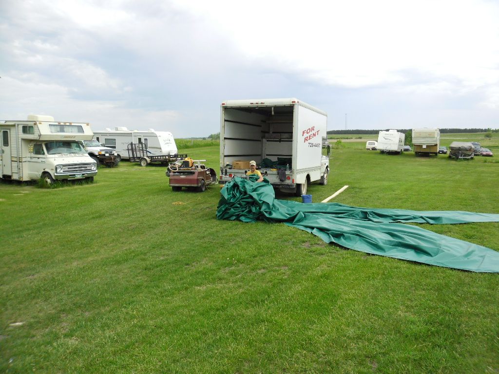

This one was 18'6"X30 if | recall.Same material you mention.
There is a sewing machine in there with me BTW.
It was larger than my entire shop so my helper (I could not move the sucker myself) had to set up in the back corner of the acreage. This was a peaked roof so we were joining triangles and flat runs so had to jam alot of material through the machine. I have done a flat tarp 25X35 by myself in the shop. No problem. In fact Dad happened to be in town and dropped by while I was sewing it and wanted to help. I made better time on my own so he just sat on the stool shaking his head at "how can you do that" LOL.
Personally---I'd talk to who ever is in charge of design and do it in sections. The arguement(s) being that it is more easily deployed/  It is repairable ( you cannot sew the middle of a tarp that size/ and it is "adjustable" in that you can add/remove sections to achieve the length you require.
