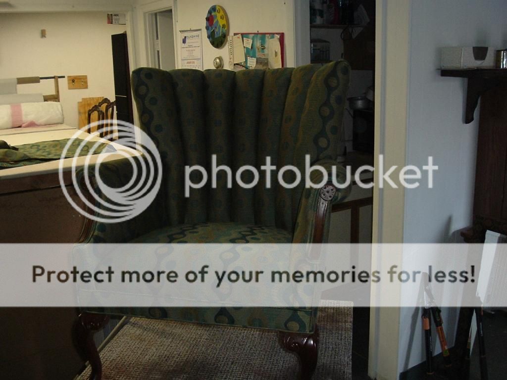

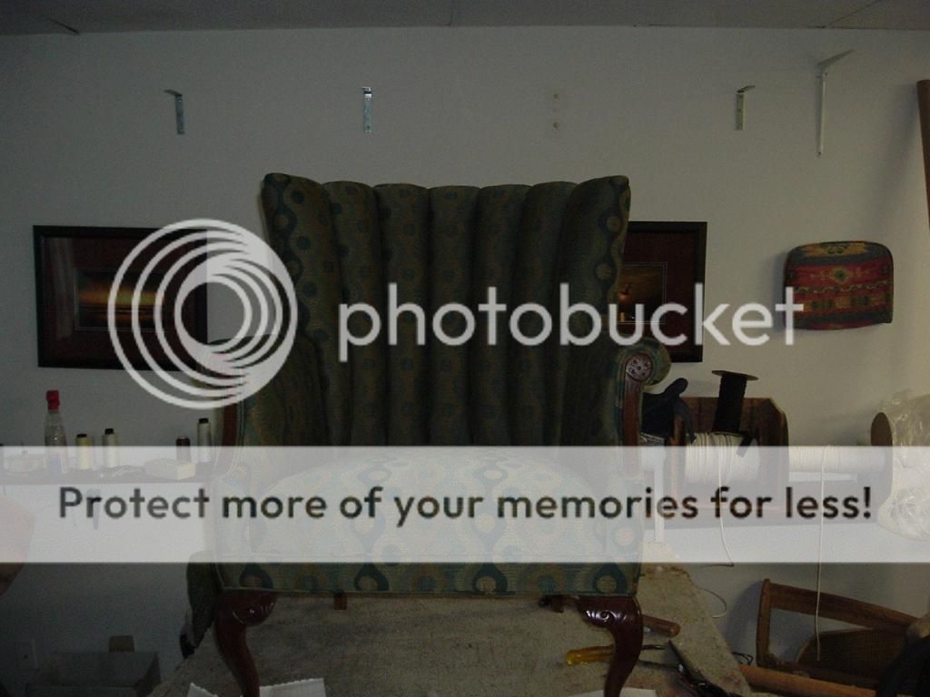

February 01, 2015, 06:19:09 am #5 Last Edit: February 01, 2015, 06:22:41 am by gene
Here be my pics of the finished chairs. Bookend matches. I ran the gold down the front edges of the channels instead of the dark blue. That turned out very nice. I think the dark blue might have put too much blue across the back and may have looked top heavy.
http://i830.photobucket.com/albums/zz228/genejoe/th_DSCF3220_zpstsmj9r2a.jpg
http://i830.photobucket.com/albums/zz228/genejoe/th_DSCF3221_zpsyfjmz6zf.jpg
