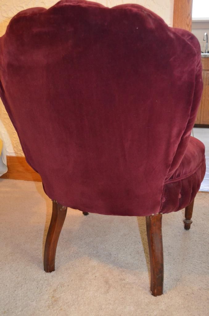

Along with everything else that is going on, we are starting tear out on an antique loveseat/chair combo that a customer dropped off weekend before last.  I've been trying to take pictures each time hubby gets something significant torn out.  I have a before picture of the chair that I will get uploaded and posted in the next few days along with another picture.
First question pertains to the picture that shows the back with what appears to be some kind of steel wool.  What is this, what is its purpose and do I want to replace it or reuse it?  If I replace it, what should I replace it with?

you got yourself in deep on this one. the steelwool looking stuff is either hogs hair or horse hair or a combination of both. Most pieces done this way should be done the same way. They are built to allow the modern ways of the trade, however it can be done. you hand stitch the hair to the burlap and then add another layer of burlap and hand stitch in an edgeroll and then again across the seat area to help shape and keep in place. I then add 1" foam and cotton and then do in muslin to see if I like it. then either add more padding or just the fabric. I very lengthy process and you need to charge a bunch for this very labor intensive.

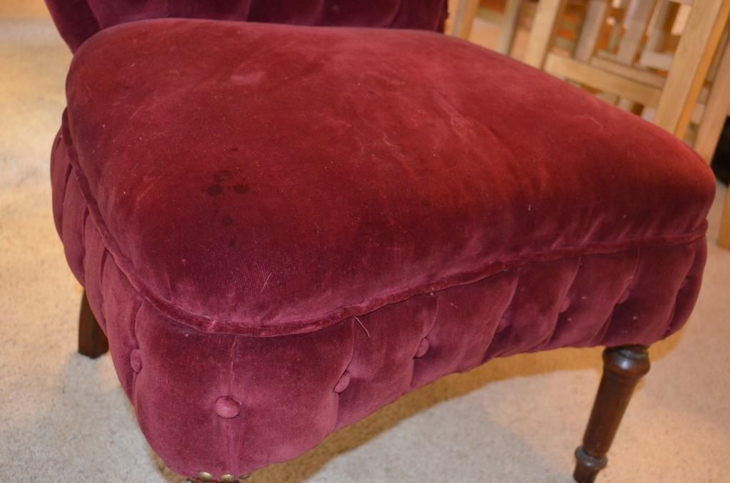

Thanks all.  I keep getting waylaid on this:  Volkswagon (getting close to being done), restaurant chairs, Carly's issues, life in general.  I'm working on the chair this morning.  Finally got the pictures ready to upload:
http://s1278.photobucket.com/user/huskerslover2001/library/Antique%20Chair
hope I did that correctly (to get the entire chair directoryP
Think I did something wrong.  If you click on the link, you get all three pictures but they don't all display on the thread.  Will try this instead:
Also, wondered where you get the correct kind of upholstery thread for this.  It's like a thin string, if that makes sense.  Never had to purchase anything like this before.
Thanks for your assistance.  I'm really excited to actually working on this this morning!

  You are delving into an antique that has been done not so well the last time. You asked about the steel wool. If it is hair I'd reuse it. If it in fact steel wool it doesn't belong. You also asked about twine. If you can find a flax or jute thread the size of nylon button twine this is what would be used to form the seat filling as mentioned by others. It is not a simple process and it is time consuming. It may not be necessary to get that far into the piece. Take off the fabric carefully so as to not disturb the filling under it and take some more pictures. It will help seeing what is under the fabric. As for the back that needs help. A channel back is sewn wedge shape sections for the front and then sewn to a backing like burlap or any fabric available as long as it is strong. Then the channels are filled from the top (wider part) with tins.
