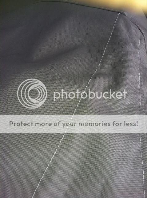

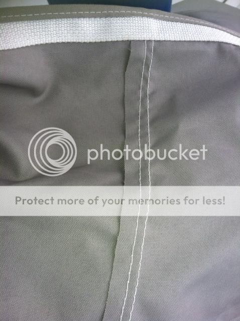

Hi all.
Have to make engine covers matching the mooring cover. But I don't recall ever seeing this type of material. It's a mooring cover on a 42' Cigarette boat.
Does anyone have an idea?

Hello.. That bottom pic looks like a material I use a lot. Called "HarborTime" provided by Tri Vantage. It is a Acrylic Coated Polyester - 11oz per sq yd - 62" wide. In fact, the color looks like Storm Grey - Tri Vantage part : 775652 - 5yr Manufacture "limited" warranty
Hope this helps
Rick
ps.. also.. around 10 bucks a yard

Looks like Aqualon to me.  Regal, if you want to PM me your address, I'll send you a swatch of white in the mail.

Looked at the fabric closer. This material is not Harbor Time and it's not Aqualon, Top Gun or any other sample card I have. The color on the inside is slightly darker and shinier than the outside. Still hunting! Going to contact Cigarette to see if they can help.
Hard to say on my monitor, but it looks like a product we use for that quite a bit--albeit on smaller boats and RV awnings outdoor covers etc...Is it lighter than sunbrella and topgun? Up here J. Ennis fabrics used to sell "wheather mate" and "weather pro".  The pro was heavier and stiffer. I have a couple of suppliers who sell a comparable material to the weather mate under the name "Barracuda".I don't have the # for Ennis U.S outlet in Indianapolis, but it's on their website.
