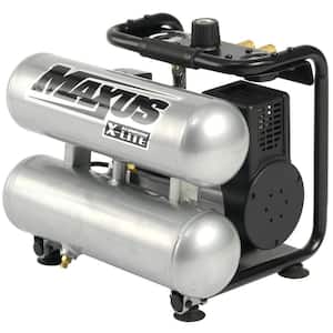

Almost all my work (repair) I do onsite.  I have one of these, with a 15 ft rubber hose.
23 lb., aluminum tanks that don't rust, fairly quiet.   Easy to tote in and out of homes or warehouses.  If it's just a corner or something, I don't even bother to plug it in, the tank will hold enough between runs.
For real infrequent use, you can get a CH steel one at Wally mart for $69-89.
