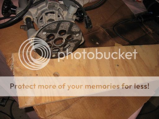

When I've made round tables, I screw a piece of plywood or Masonite as a replacement sub-base on my router.  On the unseen side, run a screw into a pivot point.   Plunge the router in and run it around the ring, plunge a bit deeper and repeat until you are through.   If that sounds too treacherous, cut a little oversize with the jigsaw or band saw and trim to the line with the router.

July 20, 2013, 07:45:18 am #6 Last Edit: July 20, 2013, 07:47:19 am by byhammerandhand
Here are a couple of photos.   Excuse the dust as I had to dig this out of my "Pile o' Jigs"
First shows how the router mounts to the fancy jig.   Remove the plastic sub-base from the router and mount onto the plywood jig.

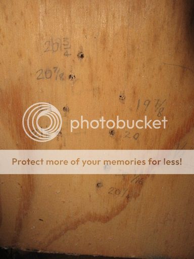

Further out are holes for pivot points for various radii.   If both sides are show wood, you can put a roofing nail into a square of Masonite, then mount the Masonite with double-sided carpet tape.   Heat the tape with a hair dryer to get it to release.

I think it would work, just that the pivot pin would be under the router and not outboard.
Your backer-board ("underlayment") is something you can secure to your good piece with double-sided carpet tape.   I like to use the "outdoor" type as it's stronger stick.  Unless you don't care if there is a through hole in your piece.
