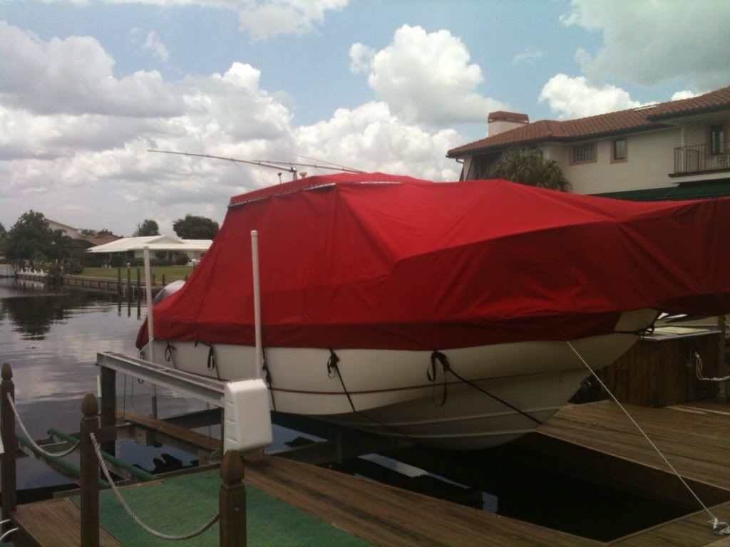

This was a full cover on a big whaler

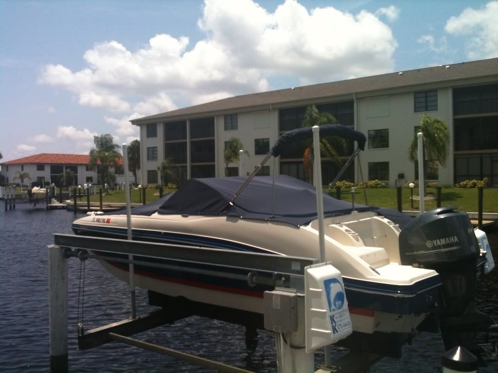

Cockpit cover in weathermax

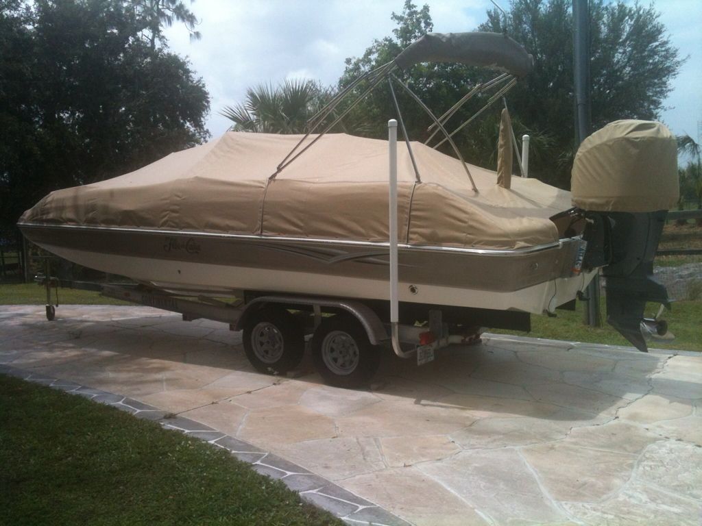

Seats covers and fly  outdura
Hurricane. Cover with motor cover
These look great, Mike! Do you install these while they're on the lift??  Don't know if I could handle that.
Beautiful as always, Mike.  Don't you just love those "over the railing" covers?  Amazing how much extra fabric that takes and how it complicates the fit.  Of course, the alternative of cuts for rail stanchions is just not an option.
Yes JoJo I have to install on the lift also wich it actually harder the. Patterning as you have nowhere to stand with the  over on I  generaly snap the front and rear then rais the boat up high enough that if I sit on the lift beams I can do the sides. Yesterday I had to float one at the dock to. Do this as the beam was to skinny.
And ya June that hurricane the guy wanted right down to the rubrail   Not fun

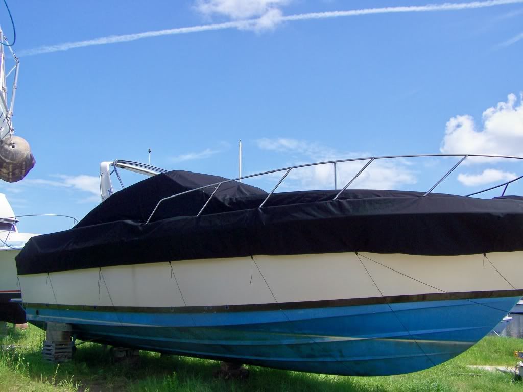

I did that on this at 40'of silverton.  request Of owner  didn't want a fabic tent and form fitting
