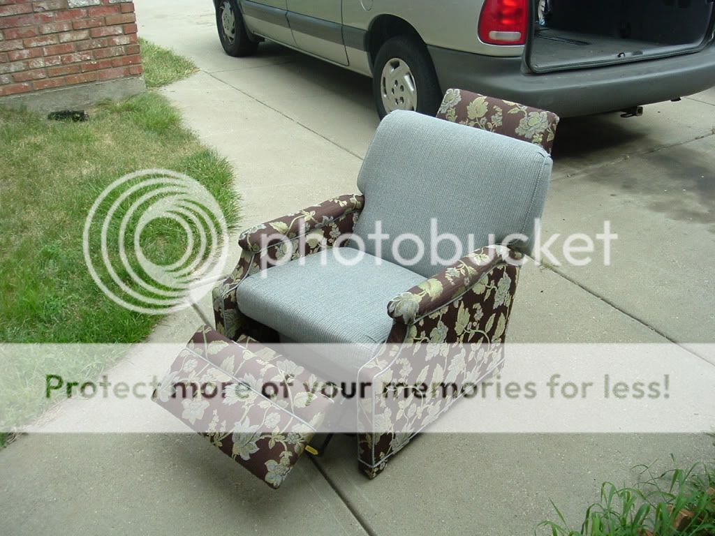

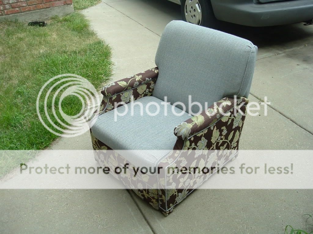

June 24, 2012, 09:45:41 am #9 Last Edit: June 24, 2012, 09:49:44 am by gene
Here's pics of the recliners I mentioned. These are pics of only one of them, but they are both identical.
My daughter got them from a neighbor for her first apartment at college.
The blue fabric is the original fabric. I had it professionally cleaned. I took the side panels of blue fabric and washed them in my washing machine and then made welt cord out of it. My daughter picked out the floral fabric, which I think is awesome. The blue in the floral fabric, which is a bit difficult to see in these pics, is the same blue as in the original fabric.
I put new foam on the foot, head, and arm rests. Notice that the head rest pops up when the chair is reclined. The head rest in the picture is not 'popped up' all the way.
There are two of these recliners matched the same.
My daughter is very lucky to have a dad that loves her and is willing to take 5% off retail price for my upholstery services.
Of course, being my daughter, I will never send her the bill - because, being my daughter, she would never pay it any way, so why bother?!?
"http://i830.photobucket.com/albums/zz228/genejoe/DSCF2478.jpg";
"http://i830.photobucket.com/albums/zz228/genejoe/DSCF2477.jpg";
Nice job Gene. Your daughter IS lucky.
Wow, that original fabric sure came clean.  You'd never know it was the original.
It looks like the RSF inside arm panel is on upside down though.
5% is a great family discount.
;D
