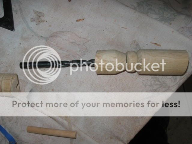

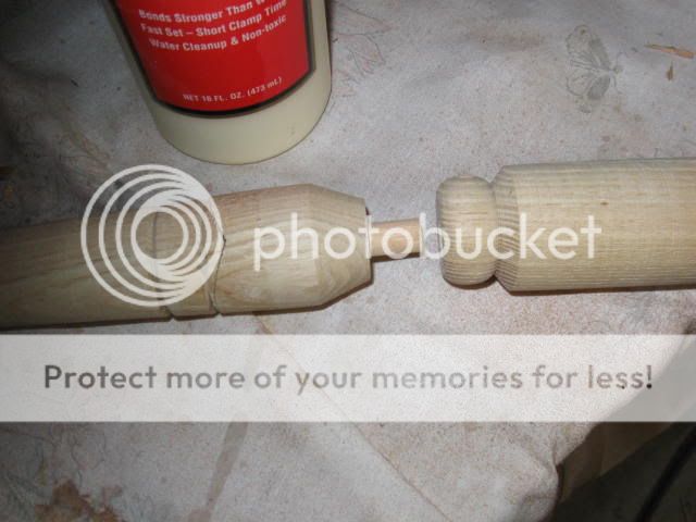

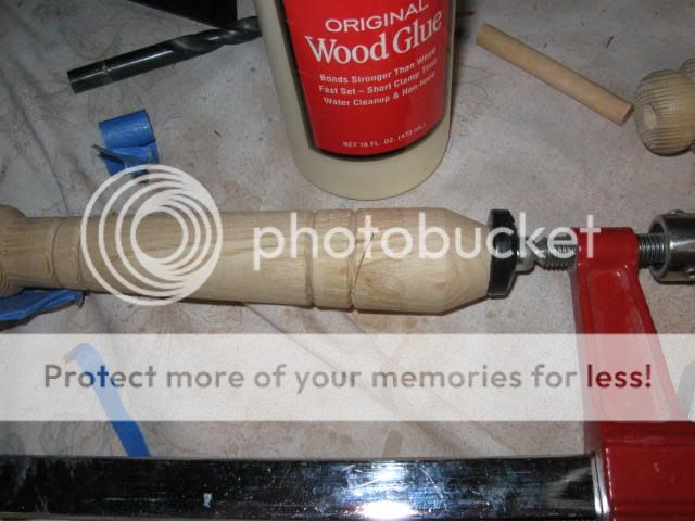

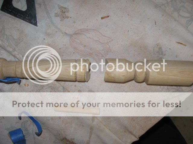

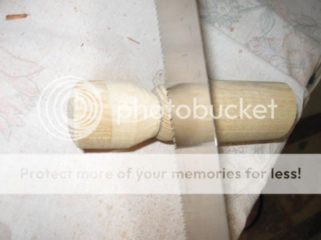

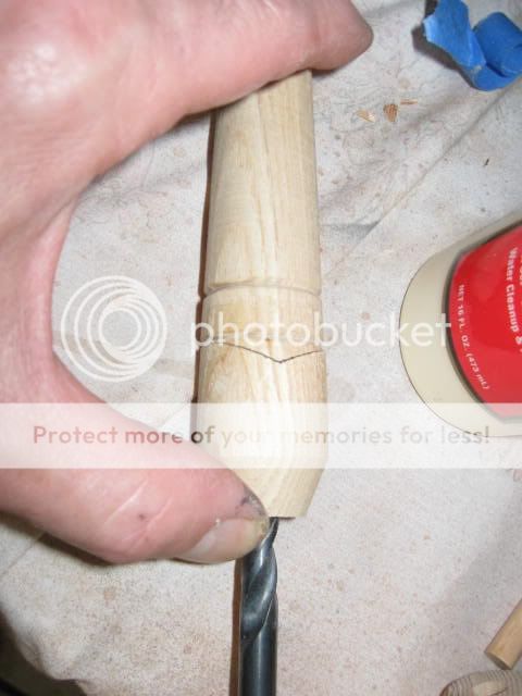

Here are some photos of a demo piece that I did:
V cut simulates a fracture.
Drill through the fracture to nearest detail
Saw off at detail
Glue and clamp on stub, then let dry
Drill the other way, your holes are now aligned
glue and dowel

When I organized my tools into a new chest earlier this year, I was shocked at the number of drill bits that I own*.  I think my choice in this would be brad point.  One difficulty is trying to get the drill started in a jagged end.   Sometimes, I'll drill a smaller hole (1/8" or less) to create a "point" for the drill bit to hit.   I also sometimes use an awl to get a starter hole, too.   The drill bit in the photos is a "bullet point" chosen for no reason other than it was already sitting on the work table.
