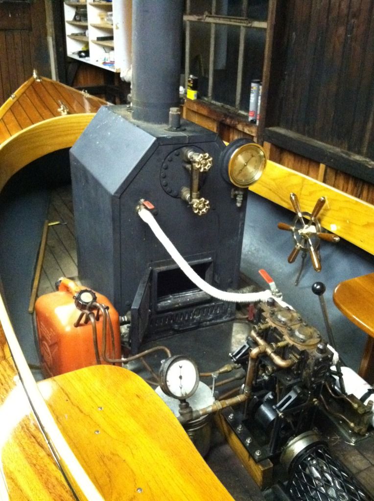

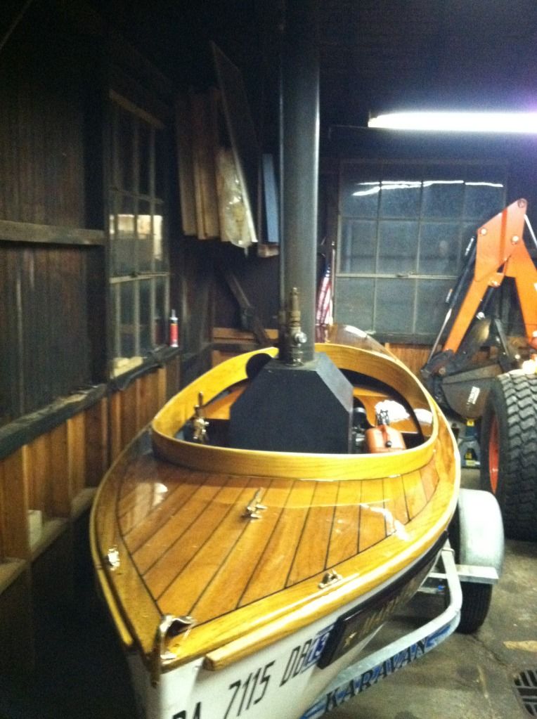

Yeah, it's a 16' steamboat.
And the stack is 6 feet high. So, how would one go about making a cover?  Here's another view:

I would think that a standard boat cover with a hole in the middle for the boiler
Then a sock to fit over the stack
So it is in two bits

Is that plastic all around or, um, oar, is that a wood deck?

Pay attention to fire code!  Sunbrella would work fine if you could be certain the owners will only put the cover on when the boiler is adequately cool...
You could use Firesist or any number of other fire-resistant fabrics for the area immediately over the boiler and the collar to go around the flue.  But make sure you address this concern with your customer!

I would do like allen just make a sock for  the stack.
And lone it with maybe herc80 or thet heat shield fabrix that silver foil like

Thats not a gas can next to the boiler, in the second pic, is it? That alone would scare me.

And yes, Eagle, that is a gas can.
So this cover will be somewhat tent shaped, with a zippered cutout for the stack and a sock over the sack. Doesn't sound like fun.
Come on Jojo, where's your sense of adventure? I like the sock idea too. Maybe with a zipper half way up so he doesn't need too high of a step ladder to get it on. I think I'd go with herculite (Samson in canada) they make a FR type. At least on the sock. Or line the Sunbrella with it.
