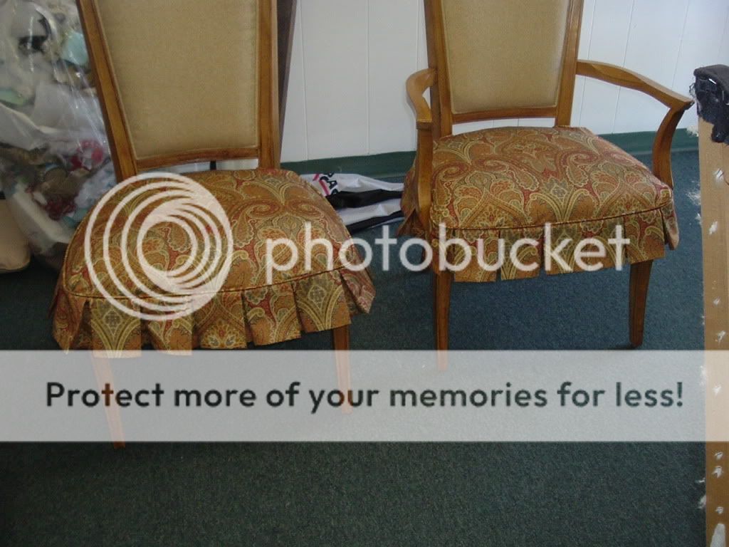

Here's my dining room slip seat covers. 4 side chairs and 2 arm chairs.
"http://i830.photobucket.com/albums/zz228/genejoe/DSCF2405.jpg";
Nice work Gene. How do you anchor them?
Those do look really nice, Gene.
I would secure those in place with a flap and velcro underneath, or maybe a couple of adjustable straps/clips, maybe with some rugged elastic.  I'd like to know what you opted for, too, Gene.

How much time did you spend doing those six covers?  How did you attach them?

Yes, flats with velcro would probably work, provided the flaps were attached to be as wide as possible.

When I used the flap idea on two "Martha Washington" chairs in my own shop I made flaps that nearly spanned the spaces between the legs.  I used 2" velcro and spent some time shaping the flaps so they could be pulled taut and really "snug down" the slipcover.
I was surprised at how fussy they were to make; the idea seemed a lot simpler than it really turned out to be.  But they work!

It's interesting, Sofa., that when you work in the marine field you deal with flaps, snaps, velcro, and all manner of little plastic doo-hickeys to fasten things in place.  It's not that way with upholstery or slipcovers... usually!  I opted for the flaps under the the chair because I wanted the slip. to retain the clean, trim appearance of the the original upholstery.
As I said, I was surprised at the amount of fiddling required to get the flaps to work the way I wanted them to and not be visible!

These were originally going to have tie backs but I choose to go with twist pins - those pig tail things with plastic heads on them.
I don't think they will need the twist pins, though, but I'll give them to the customer in case they want them. There is a skirt on the back between the back rails. They are custom fitted so I don't think they will slide off when people get up from them.
I chose not to do tie backs because they did not look good with the skirt. I did have a bit of leverage to choose what would work best. I did consider velcro but I didn't think it was needed.
