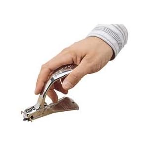

sofadoc, what is the tool, #28 in your photo bucket album? Looks like a type of staple puller.

I bought that staple puller off E-bay a few months ago. It looks like a light duty office tool. But it's actually quite sturdy. I use it on jobs that call for removal of every last staple, or when you need better control for getting out staples next to finished wood.
I made one similar to this a year or so ago.  It works well on certain staples and densities of wood.   A customer of mine showed me his that he got from a fabric supplier many years ago.   I had to buy a heavy duty staple puller at the office supply store, like this one.  Then I removed the shoe, spring, extra tongue, etc.  I stripped it to the part that hooks under the staple and the lever arm.
