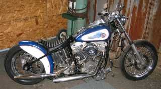

here's the bike, just welded on the hardtail..so I needed a seat. Made the pan, shapped the padding and covered the seat. Wanted to go with French seams..but I started having the thread problem and felt a little (LOT) over my head anyway. The seat could be better, but for the first time ever using an upholstery machine and figuring the patterns..I'm happy with what came out..it works for me!
