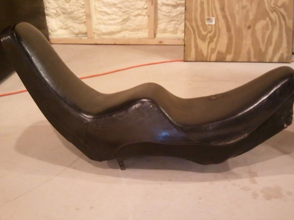

Hi guys,
How do you deal with something like this? I have this motorcycle seat, so since the vinyl wasn't in too bad shape, I thought I'd take it off and make a pattern from the old one. I'm usually really good at making patterns out of weather beaten covers, but this one has so many buckles that it won't' lay anywhere near flat. I put it out in the hot sun which made it nice and pliable, but when I put weights on it, there's just too much fabric left over when I trace around the curves.
Advice?
May 26, 2011, 02:00:54 pm #1 Last Edit: May 26, 2011, 02:07:23 pm by fragged8
hiya
I no expert at bike seats but the only 2 i did I drew the
seam lines on the foam and used pvc window material
or canvex to pattern right off the seat.
use a nice stretchy material, 4 way stretch is good
this one took a ton of pulling to get the front curve to sit flat.
Thank you so much! Don't know why I didn't think of that. :-[
I was trying to lay the black vinyl on the seat and somehow get a pattern that way, but I couldn't see the foam!
You really made my day!
I'd do like rich said.  But I have used a old skin and made cuts I. The edge to let it lay flat.
I've also layed window vinyl over the skin to bald it down flat and then mark
y pattern shape make reference mark and make he line up steaching where needed to to make the seam work.
Sometimes you will need glue in the botto
of the seat
Material may help too. Allsport that stretches both ways is the shizzy for these nutty seats !!
Mike,
The original was indeed cemented to the foam, so I plan to do that too. That is a good suggestion to make relief cuts; I'll try that first...it'll save me a trip to Joanns (or as I like to call it, "hell") for the clear vinyl.
Scarab, I will try this next time, but I've already purchased the vinyl (Spradling).
Thanks guys!
Saddleman
Take the trip to Hell for the clear vinyl or Wally World has it too if they have a fabric dept and it will be cheaper.  I always get a better fitting cover if I pull a new pattern off the seat, versus trying to copy the old one.  Just my 2 cents worth.
