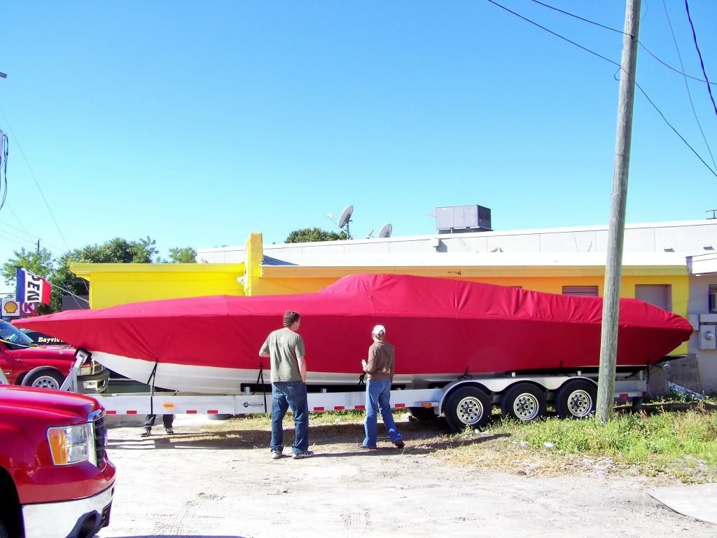

You might be looking for a poly cotton with a flannel inside. If it's one of these cig boats with the 100 g paint thats probably what he is seeking. Totally useless for outdoors but looks and works great in the garage.
I did a cover on a 36 fountian they have painted hulls so a soft canvas was needed I used outdura trio outdure if like sunbrella but the trio has a flannl like  soft liner
Pm Miami mike who is with Miami Corp who sell it
http://i782.photobucket.com/albums/yy102/Mike8560/covers/100_1418.jpg
