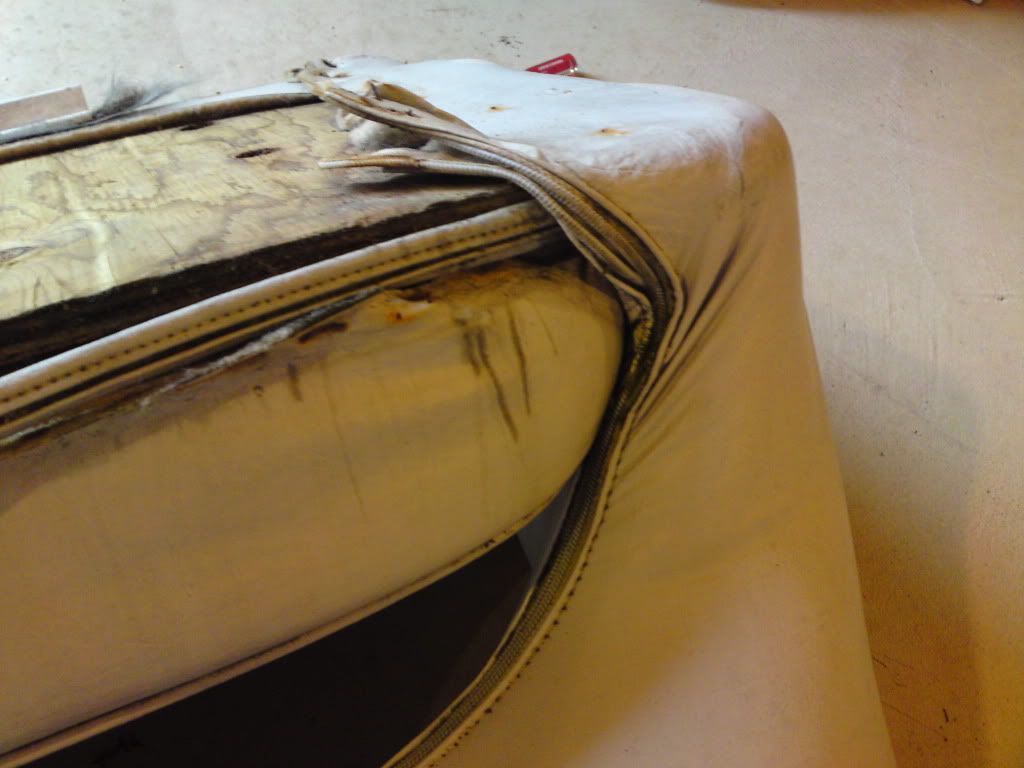

ok, started over, but new problem: it has a zipper to attach the seat back front and back pieces together. Here is a photo of the seat corner viewed from the back and  turned upside down. The zipper has to go around that curve on each side, and I'm getting serious wrinkles in the front when I zip the zipper. What am I doing wrong????
I am going to take a picture of the wrinkles and post later.
